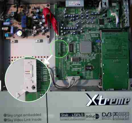

At the motherboard of Xtreme I mounted a 20pin connector, and made a cable with slow Down Circuit like example at the site of Duolabs (http://www.cellularcenter.it/cas/xtremecas2.pdf).
Note that my motherboard differs from the one shown in the picture at above site; mine also had just the solder points but not an actual connector, hence I mounted one myself. <img src="/ubbthreads/images/graemlins/biggthumpdown.gif" alt="" />I’ve put loaddrv.exe en giveio.sys into Windows\system32\drivers directory. In the root of C:\ I created directory c:\Naxjp-079 with naxjp.exe, byteblaster.txt, xilinxfile, dreamload.bin and MR*.bin files. Then I selected an FTA-channel and switched off the power from Xtreme. After that I plugged self made CasInterface2 cable with SlowDownCircuit into the mounted connecter at motherboard of the Xtreme and other side into CasInterface2. CasInterface2 powered /connected with USBcable to PC. Now I’m ready to bring Xtreme into Dreamload mode. With a loaddrv.exe I’ve installed and started the giveio.sys driver (c:\windows\system32\drivers\).

Looks like naxjp can’t connect to Xtreme.
I’ve checked: giveio.sys driver is running; cable connected according the schema of Duolabs for Xtreme, CasInterface2 connected ( it’s not really clear for me which choice to make at the CAS2menu (MR-Dreambox???) After selection of Dreambox/connect I get a message – not right connected…but Dreambox is not Xtreme – also different cable connection schema..). Please help me to bring Xtreme in Dreamload mode for reprogramming SkyCrypt CAS Interface.

Je haalt de CAS2 en CAS1 door mekaar! Wel opletten <img src="/ubbthreads/images/graemlins/grin.gif" alt="" /> !! De CAS1 moet je via een DOS box "bedienen". Bij de CAS2 is dat niet meer nodig en ook al die bestandjes niet. Download de handleiding van de CAS2 bij duolabs eens en lees die eerst eens goed door. Dan kom je een heel eind.
Mzl
Koekie
m.i. lukt dit niet, omdat een skycrypt geen UCAS based cam is. je krijgt hem daarom niet geprogged met MM of MR software.
Kijk eens bij http://www.lefdata.com/satellite/cam/ci.html en kijk dan bij de Magic Module en bij de Skycrypt module.
Dan zul je zien dat de hardware totaal verschillend is en dat je in een skycrypt module(Atsky Neotion based) (embedded of niet) nooit software kunt zetten die bedoeld is voor een Magic Module (Sidsa based).
