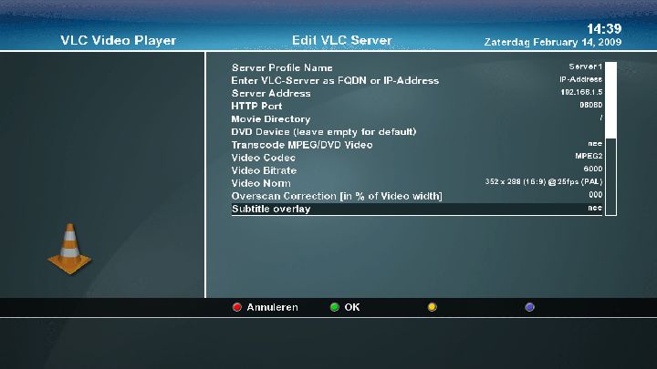

Bij mij werkt het prima. Als ik schokkend beeld heb dan kies ik een "NTSC" resolutie. Zo wie zo zet ik de bitrate ook altijd al hoger (bijv 6000 ipv de default van 2000)

Voor de dm800 gewoon de laatste VLC installeren via plugins. verbinding maken met het ip van uw PC.
Voor de PC enkel de oude versie van VLC 0.8.6 erop zetten ( remove alle vorige versies van VLC ) , VLC opstarten , ga naar instellingen --> voeg webinterface toe --> webinterface.
That's it .

This is the required sequence of operations:
Do you want to play downloaded films on your TV through your Dreambox?
1. Install VLC on your PC
2. Install VLCf on your Dreambox
3. Open file vlcf.xml which is located in Dreambox folder /var/tuxbox/config
Edit the 4 server lines and the 4 config lines to include your PC IP address and the PC Film Directory (There are 4 settings options you can select for different PCs or Directories. Change them to suit your requirements))
<server name="set1" ip="192.168.0.100" webif-port="8080" stream-port="9090" user="admin" pass="admin" />
<server name="set2" ip="192.168.0.100" webif-port="8080" stream-port="9090" user="admin" pass="admin" />
<server name="set3" ip="192.168.0.100" webif-port="8080" stream-port="9090" user="admin" pass="admin" />
<server name="set4" ip="192.168.0.100" webif-port="8080" stream-port="9090" user="admin" pass="admin" />
<config name="set1" startdir="c:/Films" cddrive="d:" />
<config name="set2" startdir="c:/" cddrive="d:”/>
<config name="set3" startdir="c:/Films" cddrive="d:" />
<config name="set4" startdir="c:/" cddrive="g:" />
The four config lines are the options that you can select in settings in the vlcf Dreambox window using the BLUE button
4. Start VLC on your PC and select File>Open Network Stream
Select UDP/RTP
Tick box Stream/Save and select settings
Tick box HTTP and enter your Dreambox IP 192.168.???.???
Click OK and OK to close both windows
On VLC, select Settings>Add Interface>Web Interface
Leave VLC running on your PC
5. Press YELLOW button on Dreambox remote control and if you have done everything correctly you will have a window showing the directories/files on your PC
Select the .avi film you want to watch and after a few moments the film will start.
I hope this helps you.

Ik zou je trancedoce mpeg/dvd video een op ja zetten en spelen met video bitrate en video norm, mijn bitrate staat gewoon op 2000, maar ik heb het probleem dat mijn pc het niet trekt en zijn cpu naar 100% jaagt
