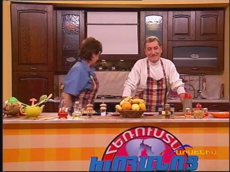

Ze zitten er toch wel
Name: "Armenia TV Foregin" Provider: "Armenia TV"
12631, H, 2170 QPSK
36.0°E (0360 - Eutelsat Sesat)
Signal: 80% Quality: 100%
NetwordID: 0 TransponderID: 0 ServiceID: 1
Video: 3649(H.264) Audio: 3665 - (MPEG-2)
PCR: 3649 PMT: 3648 Teletext: 0
ECM/EMM LIST
1) CA-Type: 19040 (0x4A60) SkyCrypt ECM: 32 (0x0020) <-- SELECTED
16-2-2009 22:57:44 (GMT +1)
