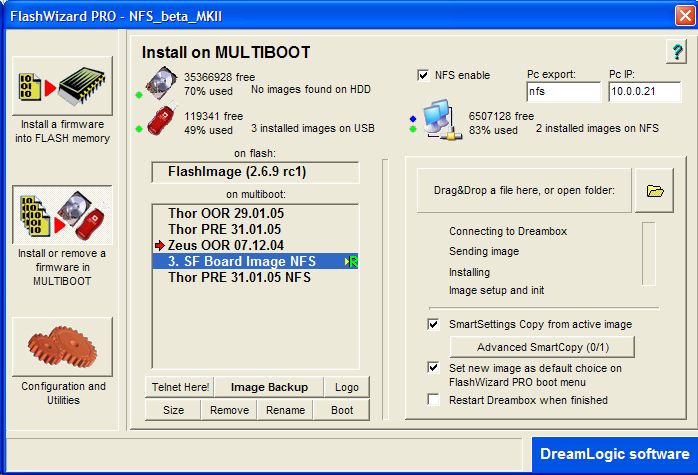

hemertje Geplaatst: 31 januari 2005 Geplaatst: 31 januari 2005 De nieuwe beta van MusicBob: Welcome to FlashWizard PRO NFS beta mkII What's new? * Added compatibility with images for DB 500 and DB 56xx They are automatically recognized and installed, just drag&drop as ever. The install beginning dialog will inform you on the dropped image. Now FlashWizard is full compatible with DB 7000, DB 56xx and DB 500 images. They can be installed either in flash and multiboot. * Added Advanced SmartCopy Allow to full copy a list of file and/or folders from active image to the new one being installed. As for SmartSettings, it is full working also with images that have a compressed /var folder at install time. WARNING_1: be careful with this option, use wildcards in filenames only if you actually know what you are doing. WARNING_2: To avoid image malfunction, do not try to copy special dir/files (like /var/etc/init) between images developed by different Teams: every developer use these files to configure their images in a different way each one from the others. If you're not an advanced user, limit the use of Advanced SmartCopy to plugins files and other useful addons ;-) Please read this NOTE: I have not a DB 5620 or DB 500. I tested DB 500 and DB 5620 images by installing them on my DB 7000, with original DMM 107.4 (kernel 2.4.20) image, just like the actual kernel of DB 500/56xx. The images are booting up ok here, until Enigma showing up. Then it gives a Fatal Error, of course, because I am trying to run a 5xxx image on a db 7000 (it says "cannot load Remote Control codes for db 7000"). So, being passed through all the boot up process, until Enigma loop, I think it is working on a real 500 and 5620, with NFS mounted device of course. But I couldn't test it myself. FINALLY... remember it is still a beta version... Have a good testing, my friends! Download op Sjerom <img src="/ubbthreads/images/graemlins/xyxthumbs.gif" alt="" /> DM8000 + DM800SE + VU+DUO + Wavefrontier T90 + 10LNBs Hemertje.Dreambox Webmaster Sat-nerds Moderator Plinux Member
Gast Geplaatst: 1 februari 2005 Geplaatst: 1 februari 2005 @Hemertje Op m’n DM7000 werkt het perfect <img src="/ubbthreads/images/graemlins/xyxthumbs.gif" alt="" /> Alleen op de DM5620 krijg ik wel een image geinstalleerd , welke na het rebooten ook keurig in FW menu staat maar niet wil niet opstarten. Het lijkt er op dat bij de 5620 het netwerk even down gaat tijdens booten , weet alleen niet of dat in de hardware zit of dat het aan te passen is in FW. gr, RuKo
Gast Geplaatst: 1 februari 2005 Geplaatst: 1 februari 2005 @allen Goed nieuws voor de DM500 en DM5620 bezitters. Ik denk dat er snel een nieuwe versie verschijnt van musicbob , Ik heb inmiddels multiboot op de 5620 werkende ...dus even geduld . <img src="/ubbthreads/images/graemlins/biggthumpup.gif" alt="" /> gr, RuKo
Gast Geplaatst: 1 februari 2005 Geplaatst: 1 februari 2005 Niemand anders hiermee bezig ? <img src="/ubbthreads/images/graemlins/confused.gif" alt="" /> Het is echt de moeite waard hoor. Het werkt alleen niet met NFSdream , dus je moet echt zoals musicbob aangeeft SFU van microsoft gebruiken. Ik krijg de var op de 5620 niet voller dan 49% <img src="/ubbthreads/images/graemlins/loldev.gif" alt="" /> Ik heb nu Gemini_56xx_102 in de flash staan en hydra56xx_zeus op multiboot. gr, RuKo
