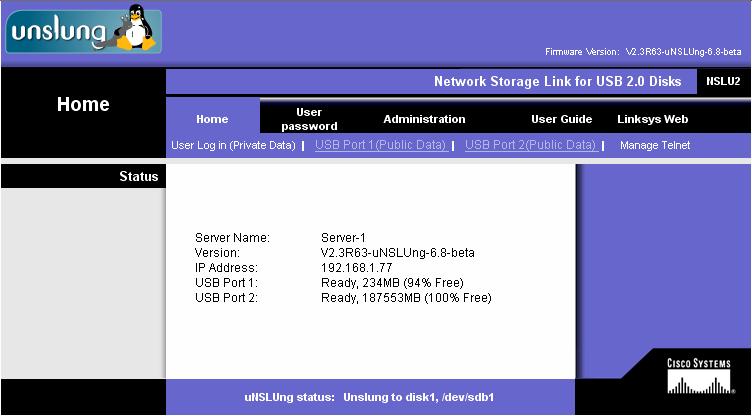

Ome Merde Geplaatst: 10 januari 2007 Auteur Geplaatst: 10 januari 2007 ik heb hem al geflashed <img src="/forums/images/graemlins/smile.gif" alt="" /> en is gelukt ... hehehe ... as we speak ben ik de usb-stick aan het formateren, die ga ik zo unslingen <img src="/forums/images/graemlins/smile.gif" alt="" /> Code: Server-1 login: rootPassword:No directory, logging in with HOME=/Welcome to Unslung V2.3R63-uNSLUng-6.8-beta -------- NOTE: RUNNING FROM INTERNAL FLASH --------This system is currently running from the internal flash memory,it has NOT booted up into "unslung" mode from an external drive.In this mode, very few services are running, and available diskspace is extremely limited. This mode is normally only usedfor initial installation, and system maintenance and recovery.BusyBox v0.60.4 (2005.03.22-06:52+0000) Built-in shell (ash)Enter 'help' for a list of built-in commands.# /sbin/unsling disk1Checking if able to unsling...Waiting for /share/hdd/data ...Target disk is /share/hdd/dataChecking that /share/hdd/data has been properly formatted...Checking that /share/hdd/data is clean...Please enter the new root password. This will be the new rootpassword used when the NSLU2 boots up with or without disksChanging password for rootEnter the new password (minimum of 5, maximum of 8 characters)Please use a combination of upper and lower case letters and numbers.Enter new password:Bad password: too simple.Warning: weak password (continuing).Re-enter new password:Password changed.Copying the complete rootfs from / to /share/hdd/data ...21016 blocksLinking /usr/bin/ipkg executable on target disk.Linking /etc/motd to the unslung motd on target disk.Updating /home/httpd/html/home.htm with target disk info.Creating /.sdb1root to direct switchbox to boot from /share/hdd/data.Unsling complete.Leave the device disk1, /dev/sdb1 plugged in, and rebootin order to boot this system up into unslung mode.# gelukt dus : merDe deze ruimte is te huur
Ome Merde Geplaatst: 11 januari 2007 Auteur Geplaatst: 11 januari 2007 okeej, ik heb unslung geïnstalleerd en via deze site mysql en php-apache geïnstalleerd. Dit is allemaal goed gegaan echter wordt apache niet gestart. Als ik dit via telnet probeer krijg ik de volgende melding : Code: #/opt/etc/init.d/S80apache starthttpd: bad user name daemon volgens mij zie ik iets over het hoofd ? <img src="/forums/images/graemlins/smile.gif" alt="" /> merDe deze ruimte is te huur

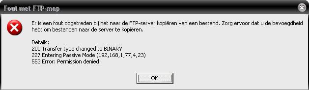

Ome Merde Geplaatst: 13 januari 2007 Auteur Geplaatst: 13 januari 2007 volgens mij moet ik een user aan de apache-groep (?) toevoegen. of root lid maken hiervan. kan iemand mij dit bevestigen en zoja, kan iemand me dan ook uitleggen hoe dit te doen ? als ik user daemon in de config verander naar root en deze via ftp terug wil schieten krijg ik een error 553 (terwijl ik als root geconnect ben). wie is hier "the man" ? <img src="/forums/images/graemlins/smile.gif" alt="" /> merDe deze ruimte is te huur
Ome Merde Geplaatst: 14 januari 2007 Auteur Geplaatst: 14 januari 2007 dit is de foutmelding die ik krijg als ik via FTP een bestand wil terugzetten : als ik het bestand met vi open kan ik er wel in maar daar heb te weinig kaas van gegeten. volgens mij is de oplossing simpeler <img src="/forums/images/graemlins/smile.gif" alt="" /> merDe deze ruimte is te huur
