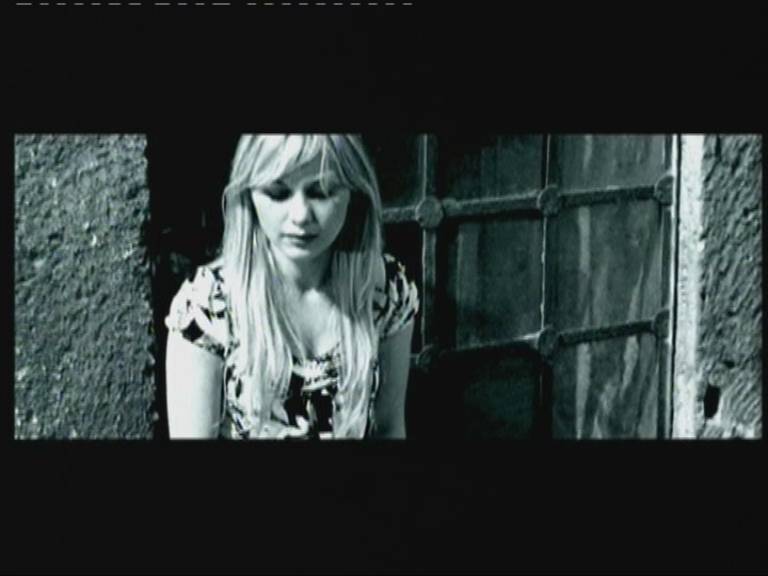

misschien hebben jullie hier wat aan
Name: "DOGU TV" Provider: "TURKSAT"
11094, V, 30000 QPSK
42.0°E (0420 - Turksat-Feed)
Signal: 0% Quality: 0%
NetwordID: 1 TransponderID: 1 ServiceID: 6
Video: 310 Audio: 259 -
PCR: 310 PMT: 2071 Teletext: 0
2-2-2009 17:14:38 (GMT +1)
