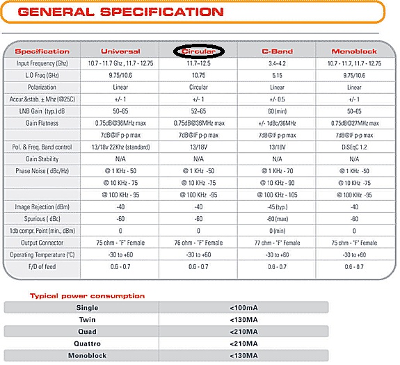

schotelgroootte , geeen idee !! 3m ??
echtre de LNB (Circular)
GT-SAT LNB Single Circular
■Single Circular LNB
■Mod. GT-SCIR40
■Typ. 0.2dB
■geringe Rauschzahl
■geringe Stromaufnahme
■hohe Frequenzstabilität
■1x F-Anschluß
■40 mm Feed-Durchmesser
■Input Freq. 11.70 - 12.75 GHz
■Output Freq. 950 - 2000 MHz
■L.O. 10.75 GHz
■Conversion Gain: 57-61 dB
■Gain Flatness 26 MHz bandwidth: +/- 0.5 dB
■Cross Pol. Isolation: 25dB (typ.)
■Image Rejection: 40 dB (min)
■LO Frequency Stability: +/- 1 MHz (max.) @ room temp.
■Current Consumption: 90 mA (typ.)
■Operating Temp. Range: -40°C ~ +65°
■Output Impedance: 75
