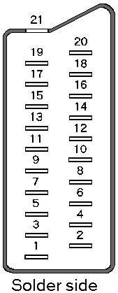

Table 1 was the original and allows for composite video input/output, RGB inputs and stereo audio. Table 2 was added to take S-video (S-VHS and Hi-8) inputs. This made pin 15 chrominance and pin 20 luminance.
Many TV sets have 2 SCART sockets. One is usually loke table 1 and the other like table 2, and pin 20 switchable from composite to S-Video luminance.
The first can switch from a composite input to RGB input. The second can switch from a composite input to an S-Video input, pin 20 being either composite in or luminance in. Usually the second socket outputs a selectable composite signal on pin 19.
Pin Signal Level Impedance
1 Audio Out Right 0.5 V rms <1k ohm
2 Audio In Right 0.5 V rms >10k ohm
3 Audio Out Left + Mono 0.5 V rms <1k ohm
4 Ground Audio
5 RGB Ground Blue
6 Audio In Left + Mono 0.5 V rms >10k ohm
7 RGB Blue In 0.7 V 75 ohm
8 Audio/RGB switch / 16:9 High (9.5-12V) AVmode
Low (0-2V) TVmode >10kohm
9 RGB Ground Green
10 Comms Data 2
11 RGB Green In 0.7 V 75 ohm
12 Comms Data 1
13 RGB Ground Red
14 Ground Data
15 RGB Red In / Chrominance 0.7 V (Chrom.: 0.3 V burst) 75 ohm
16 Blanking Signal High (1-3V) RGB
Low (0-0.4V) Composite 75 ohm
17 Ground Composite Video
18 Ground Blanking Signal
19 Composite Video Out 1V including sync 75 ohm
20 Composite Video In 1V including sync 75 ohm
21 Ground/Shield (Chassis)

dat betekent dus dat ik nr 19 moet doorknippen aan de tv zijde.
ik ben een zeikerd, maar ik vraag liever 2 keer dan dat ik het 1 keer fout doe.
