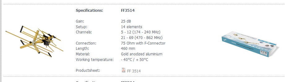

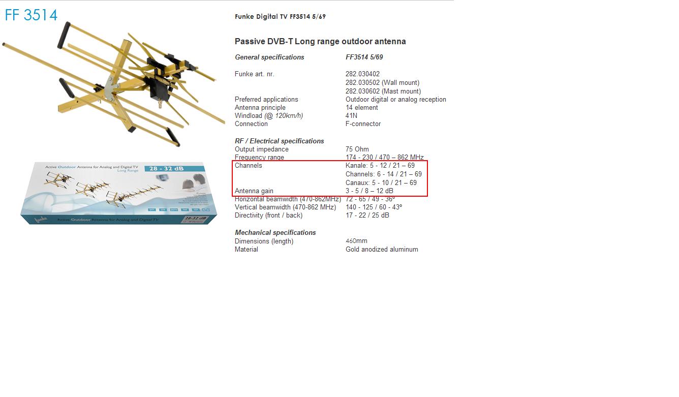

Op de site van funke staat voor de FF3514:
Channels 5 - 12 / 21 – 69
Antenna gain 3 - 5 / 8 – 12 dB
Voor de FF4538 is dit:
Channels 21 – 69
Antenna gain 11 – 16 dB
Groeten
Bart

Ik lees toch duidelijk iets anders (zie bijlage) maar ik geloof die waardes van jou direct en niet wat je op de bijlage ziet.

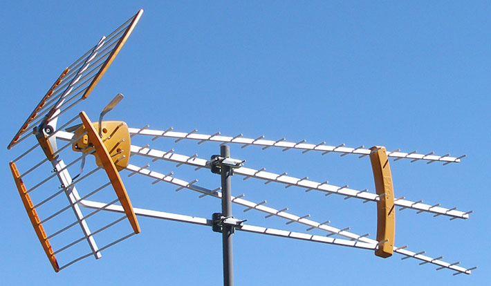

The DAT75 has a gain of 19dB which is "only" 2.5dB higher than the DAT45 (in fact about 65% more gain!)
DAT75;
Elements: 75
Channel: 21-69
Gain (dB): 19
F/B ratio (dB): 32
Length (mm): 1825
Wind 785 N/m2: 48
load 1080 N/m2 (N): 66
Bron HDprimer;
The DAT-75 has become very popular because of how grossly the maker has exaggerated its gain. It is imported from Europe, where UHF channels go up to 79. Nobody else makes these triple-decker Yagis. The three Yagis have overlapping apertures over the high channels. The only place where they are more effective than one Yagi is in the channel 38-55 range where the Yagis are just starting to work but don’t yet overlap. If you want to make a designer statement, the bright orange plastic pieces will get noticed. (A black version is also available.)
The driven element is connected to a small metal box, which contains an efficient 4-to-1 balun. The DAT-75 was found to be exceptionally well matched across the UHF TV band.
The DAT-75 is very rugged, more typical of a CATV antenna than a consumer grade antenna. Likewise its price is typical of a CATV antenna.
High gain antennas like this one are big, hard to aim, and hard to keep up in bad weather. The author does not normally recommend this antenna inside 25 miles. But there are two exceptions to this:
A very high gain antenna might be necessary behind a hill or in a valley.
When an obstruction is causing multi-path, a very directional antenna such as this one can reject signal from the wrong directions.

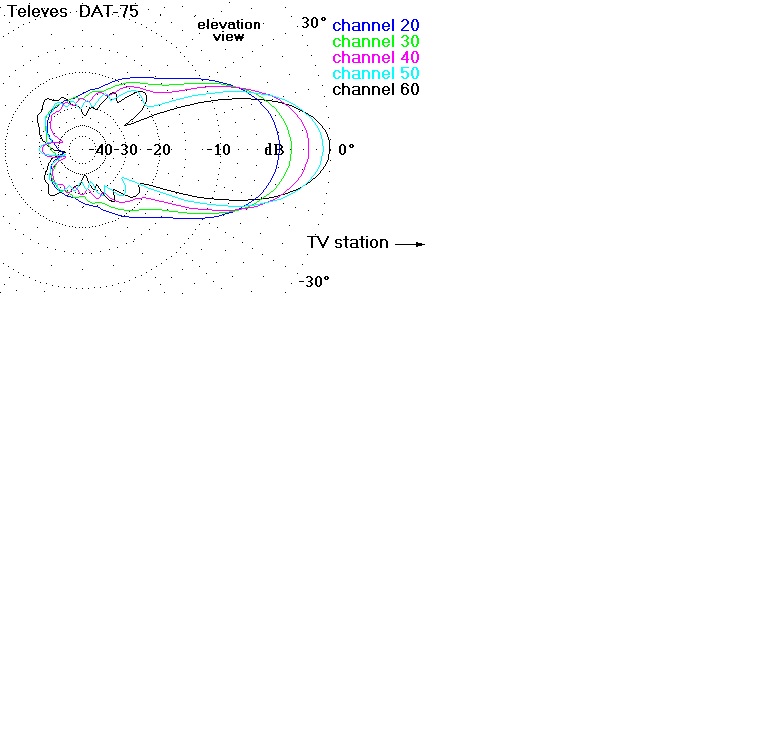

Alleen al het feit dat met een gain opgeeft in dB's geeft al aan dat deze getallen niet al te serieus moeten worden genomen. Bewust kiest met ervoor om niet aan te geven tenopzichte waarvan de gain wordt bepaald. dB geeft namelijk een verhouding aan. Is het tenopzichte van een isotope straler (dBi) of ten opzichte van een dipool (dBd). Die diagrammen is dat vertikaal of horizontaal. Het lijkt een horizontaal diagram, maar waarom staat er dan elevatie in het diagram, toch het vertikale diagram?
Zo zie je maar weer, al die waarde's die opgegeven worden door fabrikanten,wat is de juiste waarde? hoe wordt er gemeten ?
Wat is de realiteit ?
Hoe moet dat nou in een keuze meegenomen worden om tot een juiste keuze te komen van de antenne !
We willen uiteindelijk juiste geinformeerd worden om daardoor een juiste keuze te kunnen maken zodat er geen "telleurstelling" is als het produkt er staat.
Gebruikers ervaring is in de keuze dan ook een belangrijke factor.
