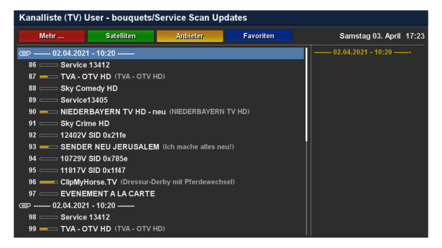

On my Dreambox it looks like this:

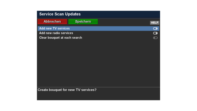

There are only a few settings:
Function:
Every time a channel search is carried out on the box, the Service Scan Updates plug-in adds all newly found channels to the "Service Scan Updates" favorites bouquet. If it is not already there, it is created automatically. A so-called marker is inserted each time so that you can see when the search took place. From there, you can transfer individual channels to one of your own favorite bouquets as usual.
In order for the bouquet to be displayed, you have to activate the Allow multiple bouquets option in the image's system settings, otherwise the bouquet will be created but not displayed.
