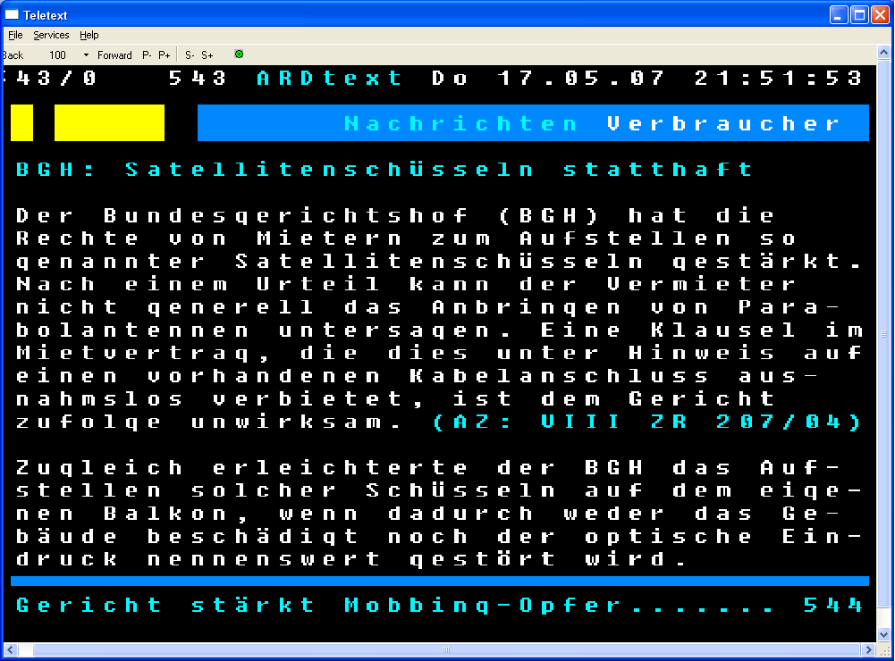

Jan Ambers Geplaatst: 17 mei 2007 Geplaatst: 17 mei 2007 Zie dienaangaande ARD TxT p543 <img src="/forums/images/graemlins/xyxthumbs.gif" alt="" /> <img src="/forums/images/graemlins/blush.gif" alt="" /> <img src="/forums/images/graemlins/xyxthumbs.gif" alt="" /> <img src="/forums/images/graemlins/xyxthumbs.gif" alt="" />
