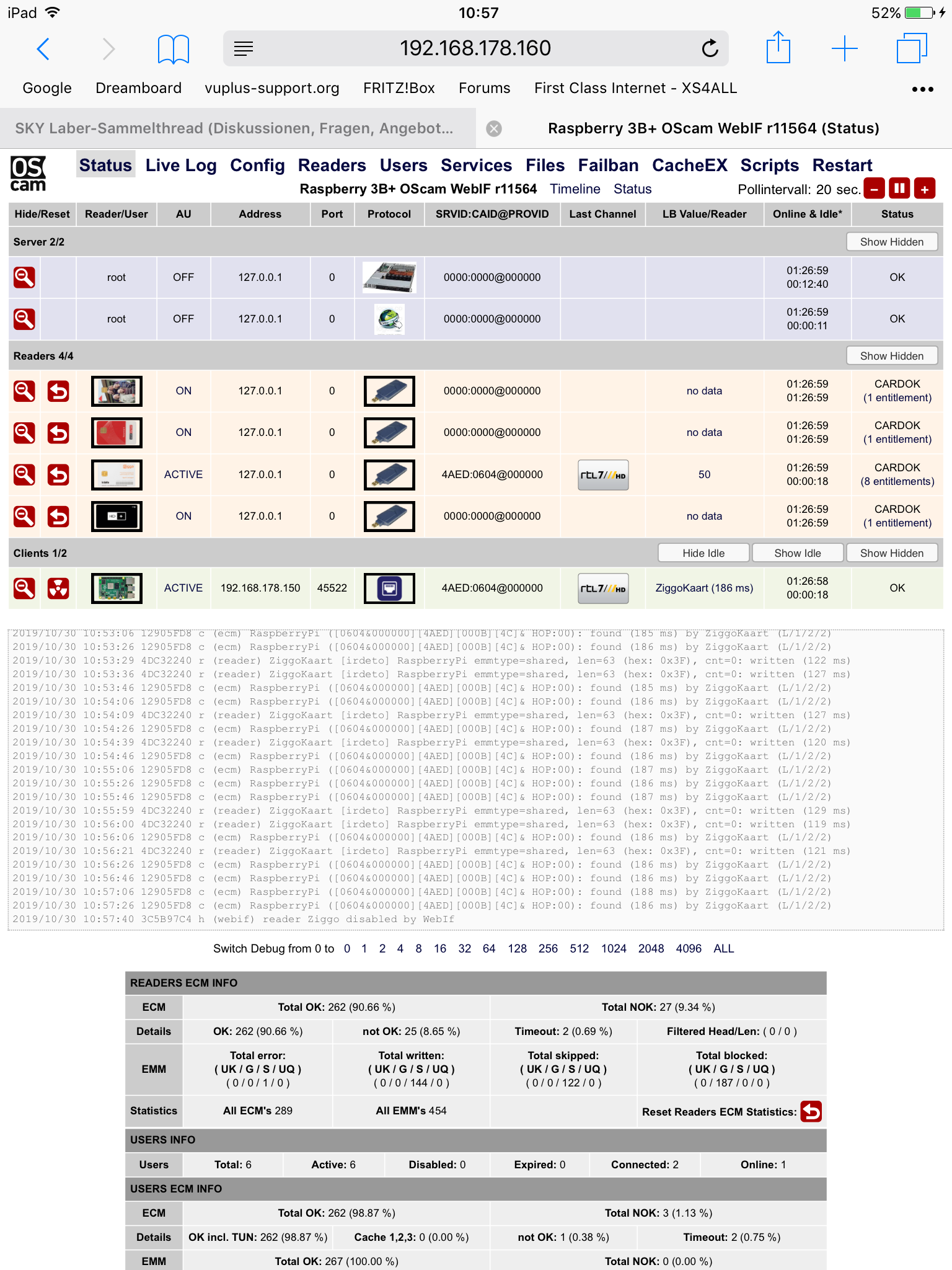

Ik heb even een regel uit de logfile van de serverbox gekopieerd, dit staat er wanneer de serverbox in standby staat.
De ultimo4K is in dit geval de client.
(ecm) ultimo4K (0606@000000/0000/4AED/4A:99535B4E3DAC4BD8A38664571A881292): rejected (166 ms) by Ziggo_1 (Invalid ecm type for cardfir
(Invalid ecm type for cardfir......

Dit is mijn oscam config
# oscam.conf generated automatically by Streamboard OSCAM 1.20-unstable_svn SVN r11377
# Read more: http://www.streamboard.tv/svn/oscam/trunk/Distribution/doc/txt/oscam.conf.txt
[global]
disablelog                    = 1
logfile                       = /tmp/oscam.log
pidfile                       = /tmp/oscam.pid
unlockparental                = 1
nice                          = -10
maxlogsize                    = 100
waitforcards                  = 0
preferlocalcards              = 2
usrfile                       = /tmp/user.log
cwlogdir                      = /var/log/
emmlogdir                     = /var/log/
[cache]
[cccam]
port                          = 14500
serverip                      = 192.168.178.52
nodeid                        = 4BB9686B104B1466
version                       = 2.0.11
[dvbapi]
enabled                       = 1
au                            = 1
pmt_mode                      = 0
user                          = dvbapi_local
boxtype                       = dreambox
[webif]
httpport                      = 83
httpallowed                   = 127.0.0.1,192.168.0.0-192.168.255.255,10.0.0.0-10.255.0.255,255.255.255.255
httposcamlabel                = Oscam WebInterface

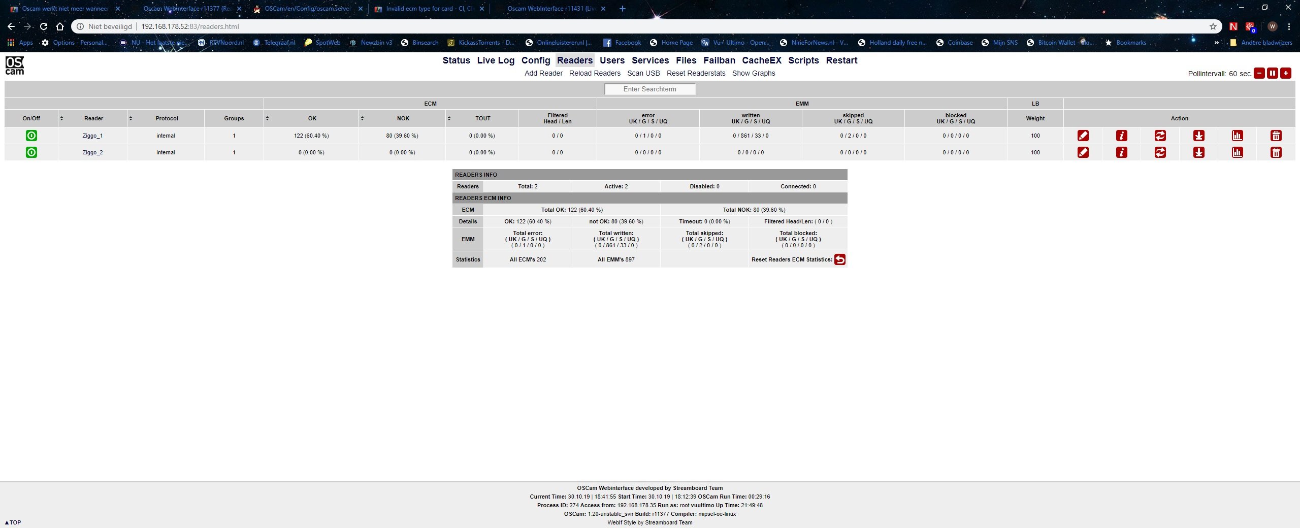

Dit is mijn oscam server
# oscam.server generated automatically by Streamboard OSCAM 1.20-unstable_svn SVN r11377
# Read more: http://www.streamboard.tv/svn/oscam/trunk/Distribution/doc/txt/oscam.server.txt
[reader]
label                         = Ziggo_1
protocol                      = internal
device                        = /dev/sci0
autospeed                     = 0
fallback                      = 1
caid                          = 0606
boxkey                        = 1122334455667788
rsakey                        =
detect                        = cd
mhz                           = 450
cardmhz                       = 2700
ident                         = 0606:000000,000001,000002,000003,0C5217
group                         = 1
emmcache                      = 1,1,15,0
auprovid                      = 0C5217
[reader]
label                         = Ziggo_2
protocol                      = internal
device                        = /dev/sci1
autospeed                     = 0
caid                          = 0606
boxkey                        =
rsakey                        =
detect                        = cd
mhz                           = 450
cardmhz                       = 2700
group                         = 1
emmcache                      = 1,1,15,0
auprovid                      = 0C5217

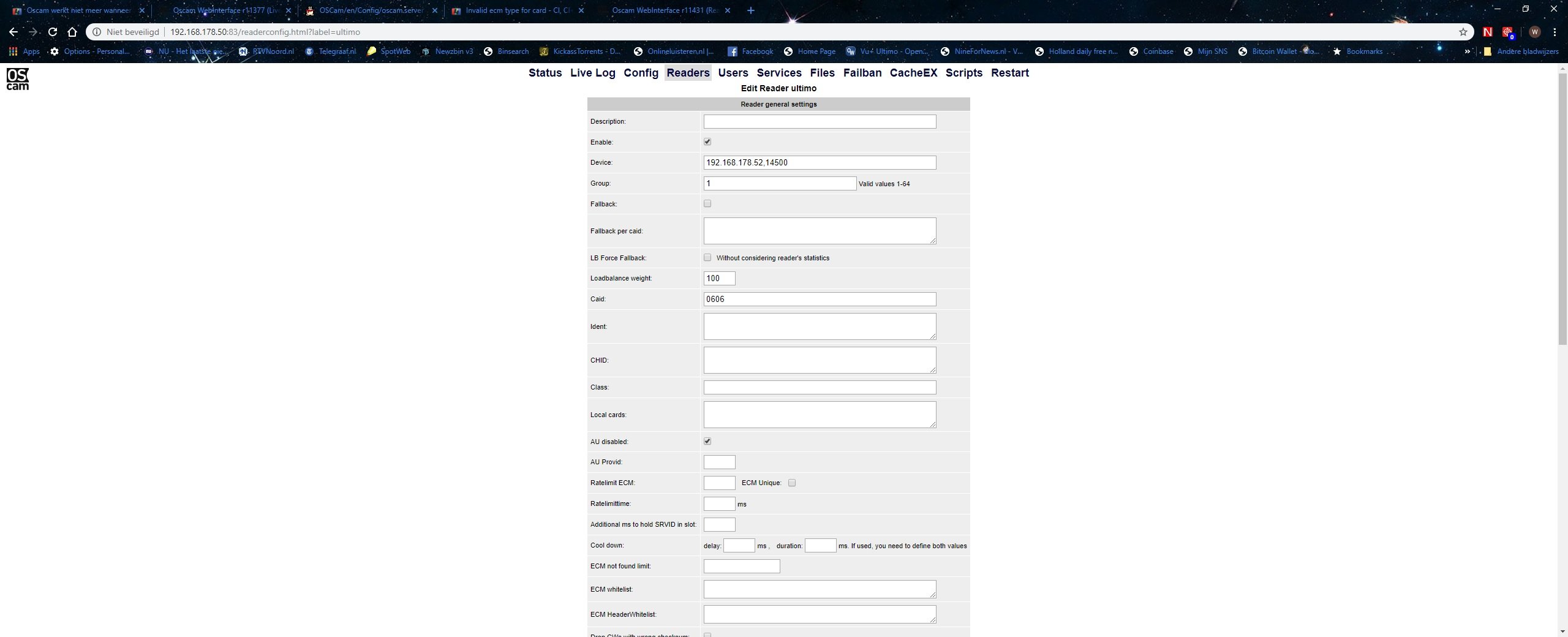

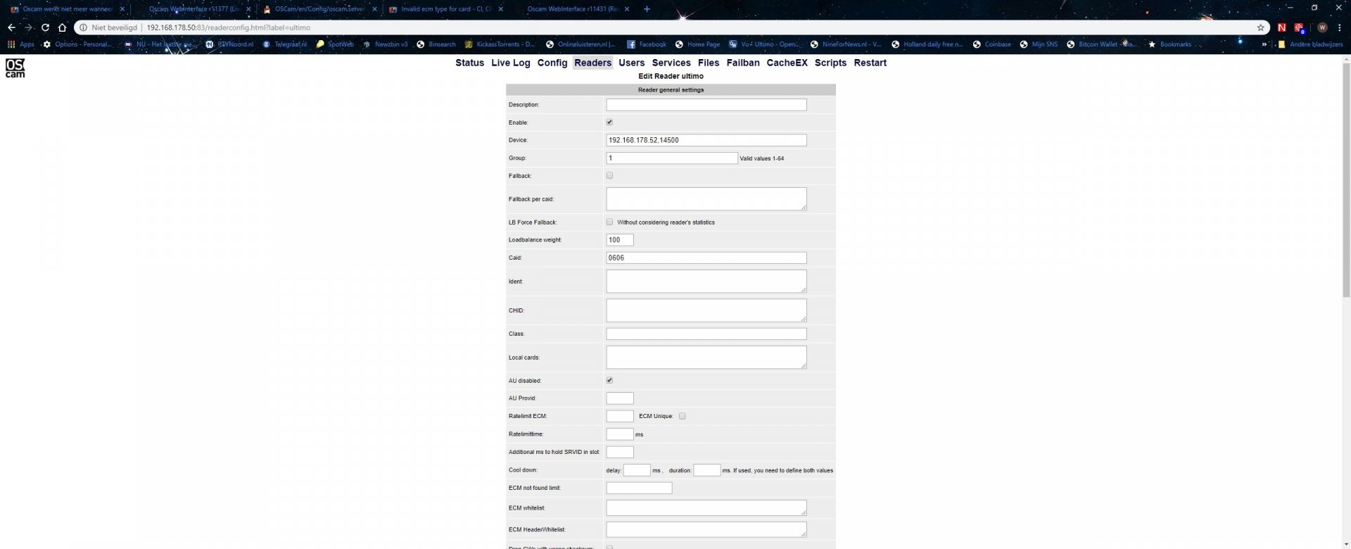

Zie het probleem al... Je hebt gewoon 2 readers aangemaakt voor de server ontvanger.. Ik zie geen sharing protocol (cs378x) o.i.d.
De client box moet verbinding maken met je server.. Op de client heb je iets in de reader staan als:
label = Client
description = Connectie met de server
device = 192.168.178.88, 12005
user =
password =
group =

@Mimisiku
Ik heb zoals je zei de CCcam protocol eruit gehaald en gebruik nu cs357x als protocol en ik heb in ieder geval gelijk al beeld.
Morgenvroeg zal ik even checken bij de clientbox als er nog steeds connectie is via dit protocol.
