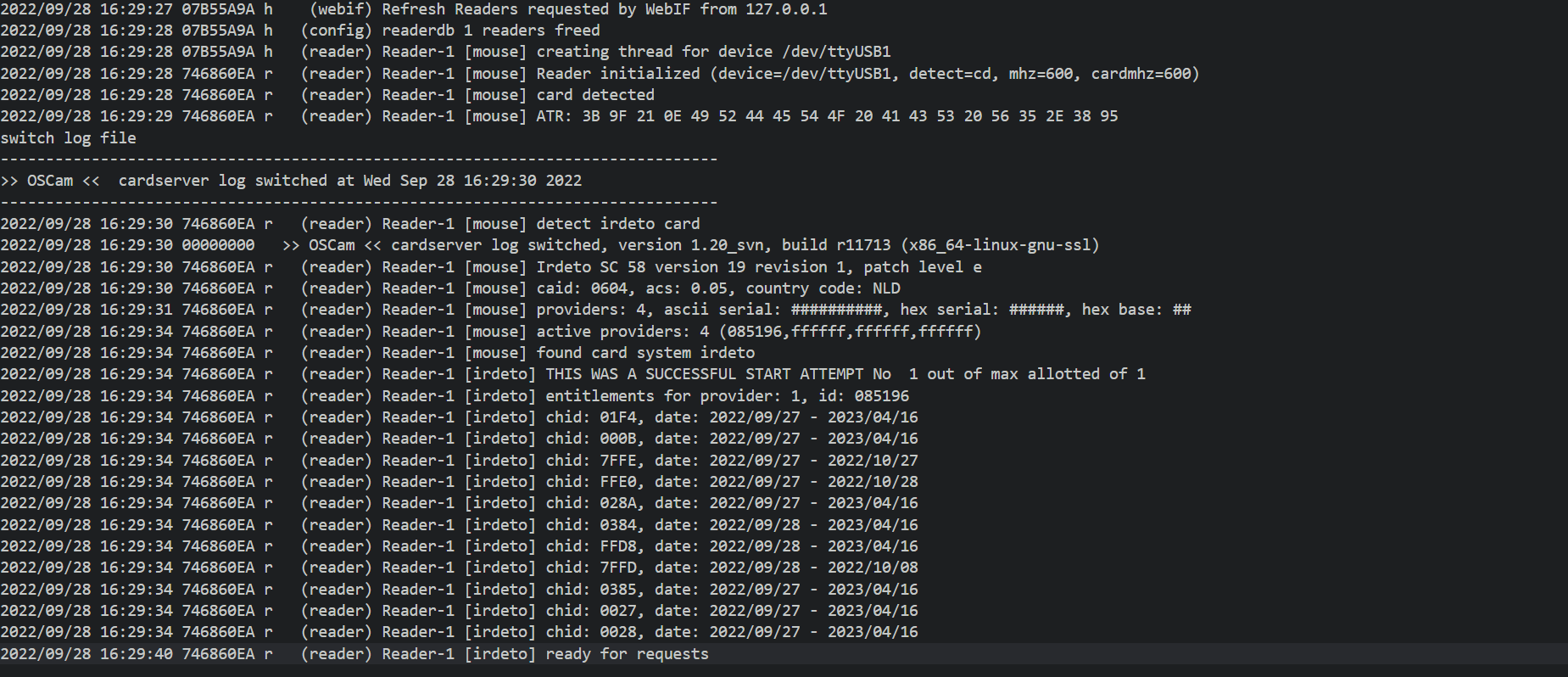

Zakaria Geplaatst: 28 september 2022 Auteur Geplaatst: 28 september 2022 (aangepast) Oscam zegt irdeto_do_cmd[8] not found... Kan zijn dat het aan de oude (@)home ci kaart ligt. Als ik thuis ben zal ik een nieuwere ci+ kaart proberen 2022/09/28 08:17:02 0DBAAB4B c (ecm) admin (0604@000000/270E/4B6B/44:B76D8D4EBD098C0F2F8153F3650C0EE5): not found (112 ms) by Reader-1 (Reader-1 unsubscribed chan)2022/09/28 08:17:13 0DBAAB4B c (ecm) admin (0604@000000/01F4/4B6B/44:E84D63952D4150B30BA5432DCD60CE53): not found (354 ms) by Reader-1 (Reader-1 irdeto_do_cmd [8])2022/09/28 08:17:13 0DBAAB4B c (ecm) admin (0604@000000/01FE/4B6B/44:245CCB10147C08E73D781E0FC7F4760C): not found (109 ms) by Reader-1 (Reader-1 unsubscribed chan) 2022/09/28 08:18:36 06058ADC h (config) readerdb 2 readers freed2022/09/28 08:18:36 06058ADC h (reader) Reader-1 [mouse] creating thread for device /dev/ttyUSB12022/09/28 08:18:36 662B65FF r (reader) Reader-1 [mouse] Reader initialized (device=/dev/ttyUSB1, detect=cd, mhz=600, cardmhz=600)2022/09/28 08:18:37 662B65FF r (reader) Reader-1 [mouse] card detected2022/09/28 08:18:38 662B65FF r (reader) Reader-1 [mouse] ATR: 3B 9F 21 0E 49 52 44 45 54 4F 20 41 43 53 20 56 35 2E 33 9E 2022/09/28 08:18:39 662B65FF r (reader) Reader-1 [mouse] detect irdeto card2022/09/28 08:18:39 662B65FF r (reader) Reader-1 [mouse] Irdeto SC 53 version 36 revision 1, patch level e2022/09/28 08:18:39 662B65FF r (reader) Reader-1 [mouse] caid: 0604, acs: 6.06, country code: NLD2022/09/28 08:18:39 662B65FF r (reader) Reader-1 [mouse] providers: 4, ascii serial: ##########, hex serial: ######, hex base: ##2022/09/28 08:18:42 662B65FF r (reader) Reader-1 [mouse] active providers: 4 (040b4c,ffffff,ffffff,ffffff)2022/09/28 08:18:42 662B65FF r (reader) Reader-1 [mouse] found card system irdeto2022/09/28 08:18:42 662B65FF r (reader) Reader-1 [irdeto] THIS WAS A SUCCESSFUL START ATTEMPT No 1 out of max allotted of 12022/09/28 08:18:42 662B65FF r (reader) Reader-1 [irdeto] entitlements for provider: 1, id: 040B4C2022/09/28 08:18:42 662B65FF r (reader) Reader-1 [irdeto] chid: EFFF, date: 2008/05/20 - 2008/06/032022/09/28 08:18:42 662B65FF r (reader) Reader-1 [irdeto] chid: 270F, date: 2008/05/20 - 2008/06/032022/09/28 08:18:42 662B65FF r (reader) Reader-1 [irdeto] chid: 000B, date: 2022/09/26 - 2023/04/152022/09/28 08:18:42 662B65FF r (reader) Reader-1 [irdeto] chid: 7FFE, date: 2021/07/17 - 2021/08/162022/09/28 08:18:42 662B65FF r (reader) Reader-1 [irdeto] chid: FFE0, date: 2022/09/26 - 2022/10/272022/09/28 08:18:42 662B65FF r (reader) Reader-1 [irdeto] chid: 0384, date: 2022/09/27 - 2023/04/152022/09/28 08:18:42 662B65FF r (reader) Reader-1 [irdeto] chid: 028A, date: 2022/09/26 - 2023/04/152022/09/28 08:18:42 662B65FF r (reader) Reader-1 [irdeto] chid: 0028, date: 2022/09/26 - 2023/04/152022/09/28 08:18:42 662B65FF r (reader) Reader-1 [irdeto] chid: FFD8, date: 2022/09/27 - 2023/04/152022/09/28 08:18:42 662B65FF r (reader) Reader-1 [irdeto] chid: 7FFD, date: 2022/09/27 - 2022/10/072022/09/28 08:18:43 662B65FF r (reader) Reader-1 [irdeto] chid: 0385, date: 2022/09/26 - 2023/04/152022/09/28 08:18:43 662B65FF r (reader) Reader-1 [irdeto] chid: 0027, date: 2022/09/26 - 2023/04/152022/09/28 08:18:43 662B65FF r (reader) Reader-1 [irdeto] chid: 01F4, date: 2022/09/26 - 2023/04/152022/09/28 08:18:48 662B65FF r (reader) Reader-1 [irdeto] ready for requests 28 september 2022 aangepast door Zakaria

Zakaria Geplaatst: 28 september 2022 Auteur Geplaatst: 28 september 2022 oscam.server [reader] label = Ziggo protocol = mouse device = /dev/ttyUSB1 caid = 0604 boxkey = <weg> rsakey = <weg> fix07 = 0 force_irdeto = 1 detect = cd mhz = 600 cardmhz = 600 group = 1 emmcache = 1,3,2,0 auprovid = 085196 read_old_classes = 0

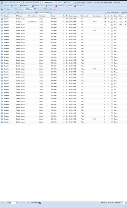

Zakaria Geplaatst: 23 mei 2023 Auteur Geplaatst: 23 mei 2023 ik ben vandaag compleet opnieuw begonnen, alles gereset. oscam doet het nu aleen tvheadend werkt tegen. ik krijg telkens maar 35 "zenders" waarvan 33 config voor set top boxen zijn en de andere info kanalen "Ziggo Live Events" en "Secret circle info"
Tonskidutch Geplaatst: 24 mei 2023 Geplaatst: 24 mei 2023 waarom heb je een auprovid ingesteld (als dat nu na 7 maanden nog zo is) ? Je Danse Le Mia Corine

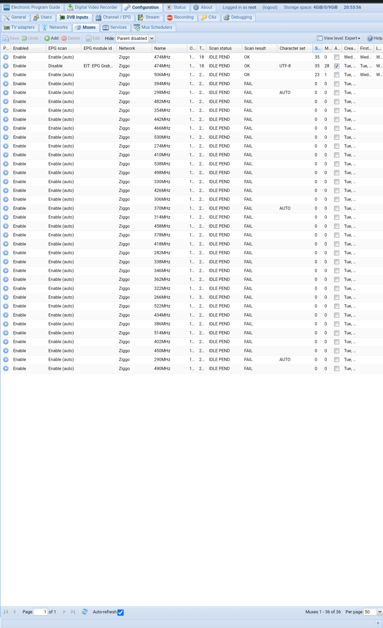

Zakaria Geplaatst: 24 mei 2023 Auteur Geplaatst: 24 mei 2023 (aangepast) Ik heb er ondertussen geen au provider meer in staat, het is alleen dat tvheadend geen echte kanalen geeft. Ik heb een signal strength van +- 70%. Gek is wel dat ik vroeger wel kanalen te pakken kreeg maar nu faalt elke scan behalve op 474mhz. Terwijl hij vroeger ook op andere frequenties zenders pakte 24 mei 2023 aangepast door Zakaria
Mimisiku Geplaatst: 24 mei 2023 Geplaatst: 24 mei 2023 474 Mhz is nu de standaard de startfrequentie van Ziggo. Met Netwerk zoeken zou hij alles moeten vinden. Afscheid….. Nog een paar maandjes te gaan…
Zakaria Geplaatst: 24 mei 2023 Auteur Geplaatst: 24 mei 2023 Dat is dus het ding, die is de enige die ook werkt maar die vindt er maar 35

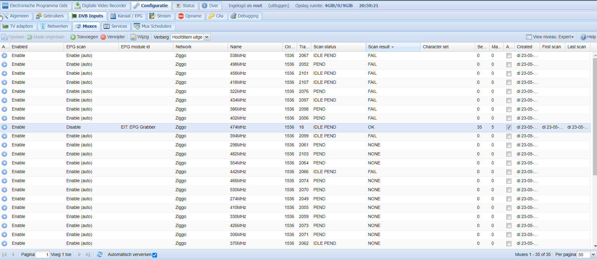

Zakaria Geplaatst: 24 mei 2023 Auteur Geplaatst: 24 mei 2023 (aangepast) Er zijn net 23 zenders binnengelopen vi mux op 506mhz 24 mei 2023 aangepast door Zakaria
Mimisiku Geplaatst: 24 mei 2023 Geplaatst: 24 mei 2023 Oude cable.xml? Afscheid….. Nog een paar maandjes te gaan…
Zakaria Geplaatst: 24 mei 2023 Auteur Geplaatst: 24 mei 2023 (aangepast) Niet dat ik weet, tenzij tvheadend die automatisch ophaalt. Dit was een complete clean install (system wipe) 24 mei 2023 aangepast door Zakaria
