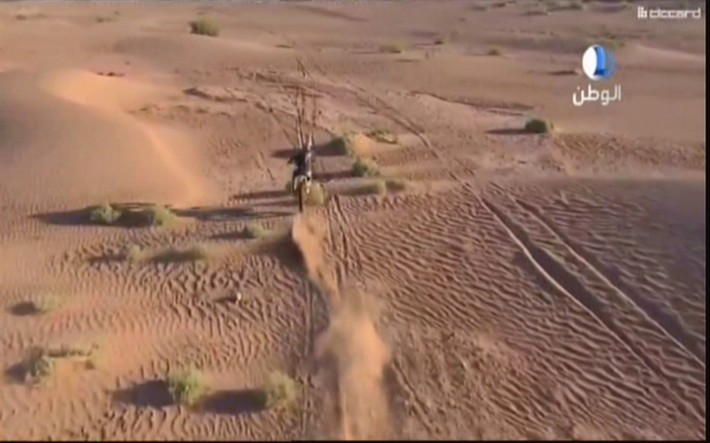

7°W
10922 V 27500 5/6

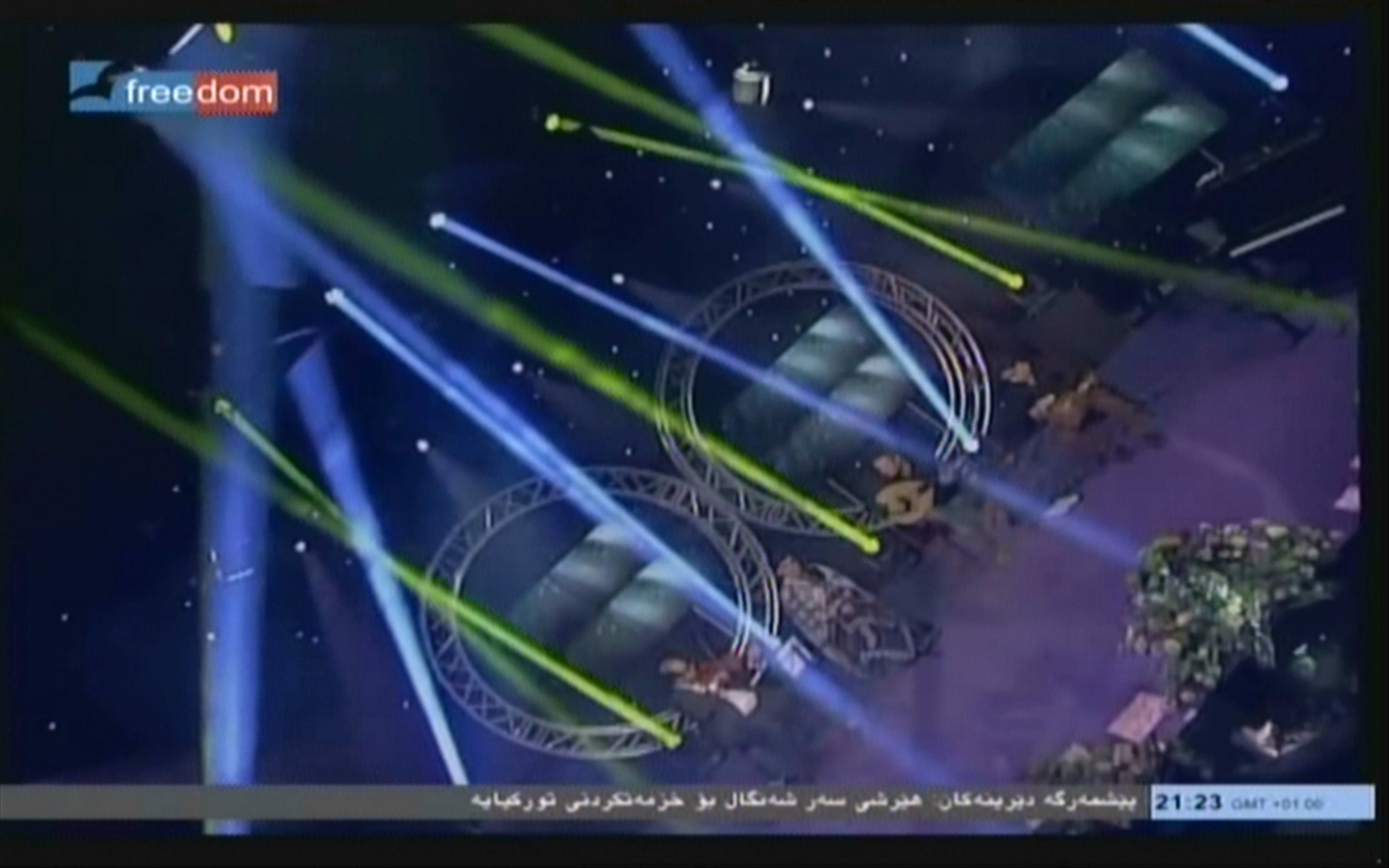

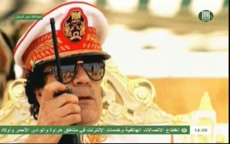

11354 V 27500 5/6

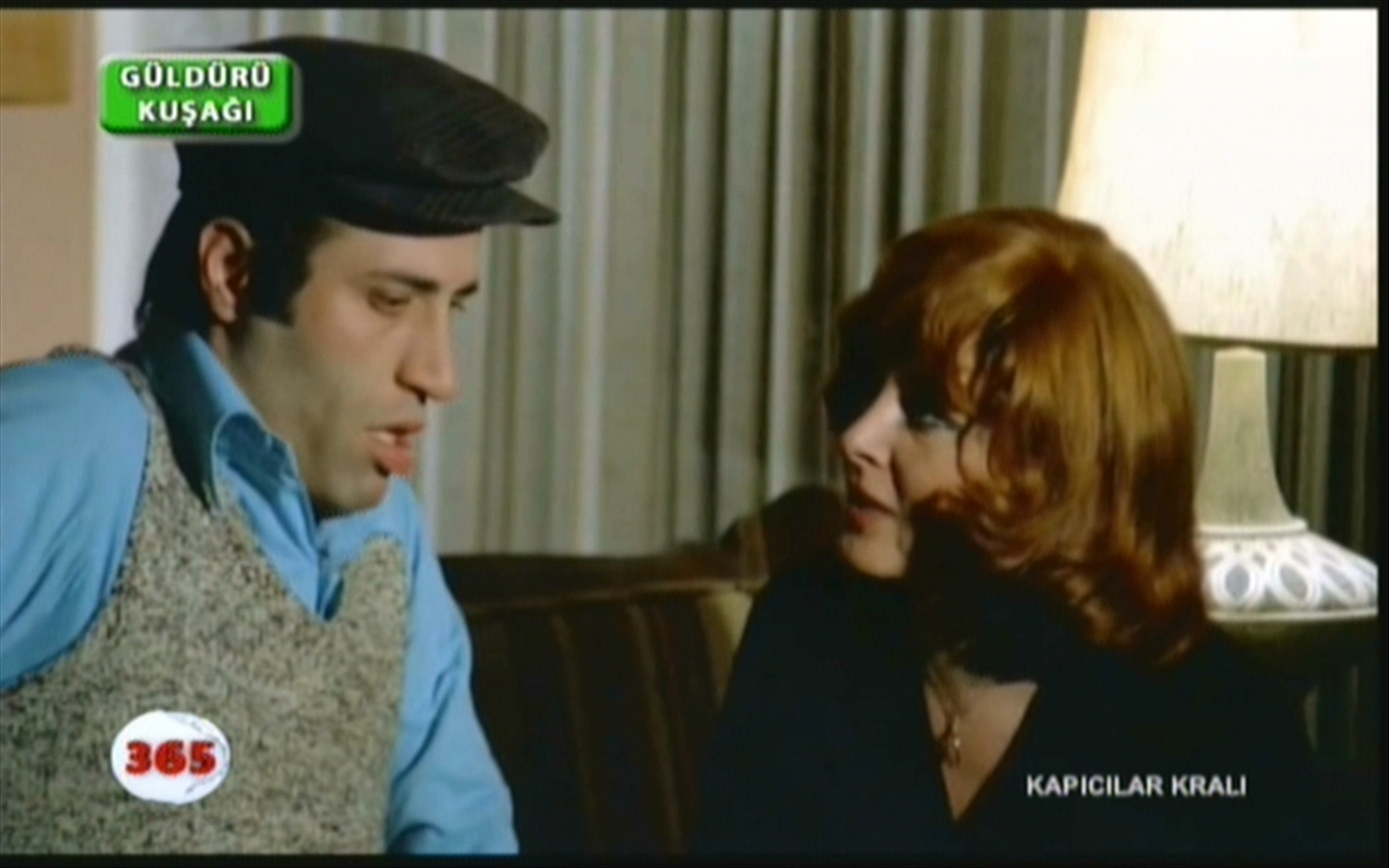

42°E 11096 V 30000 5/6

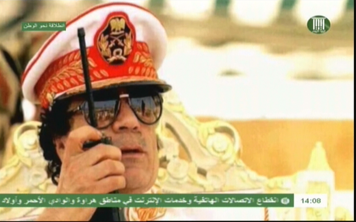

8°W 12604 H 27500 5/6
ID: Libya Today TV

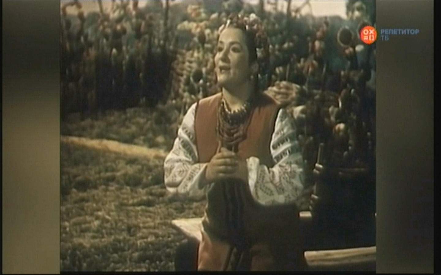

5°E 12073 H 27500 3/4

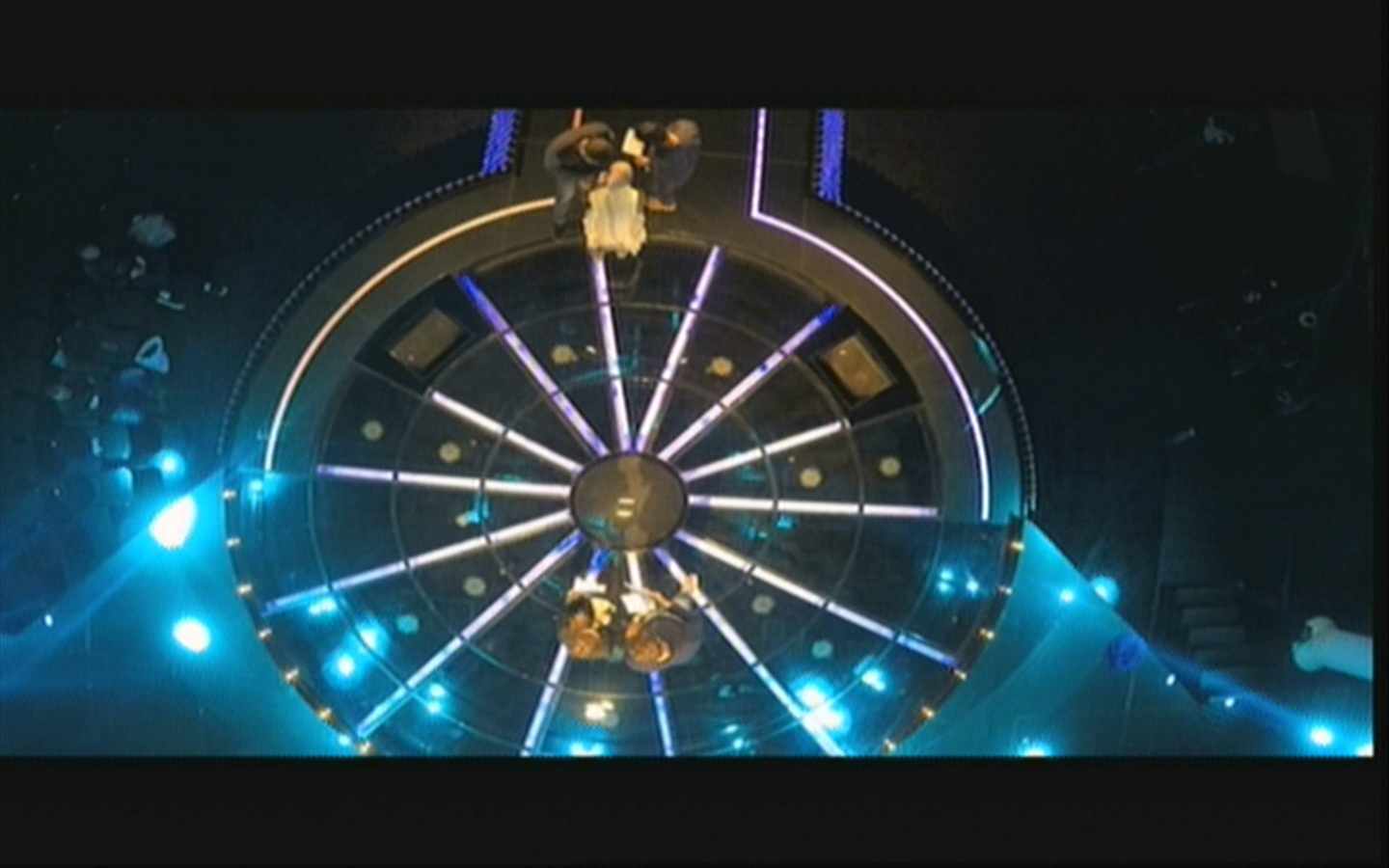

7°W 10930 H 27500 5/6

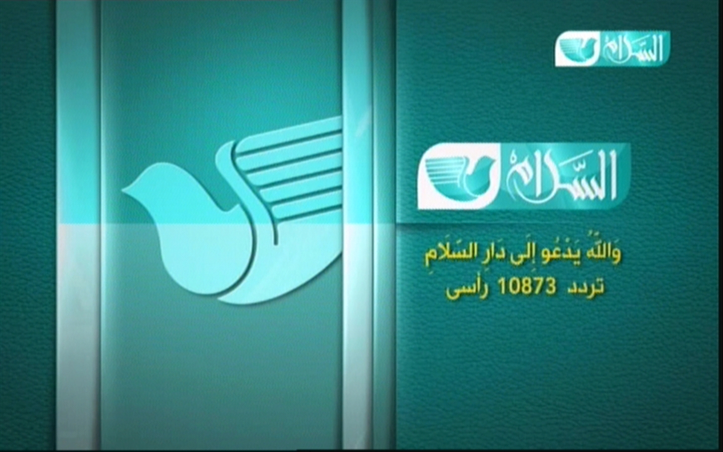

7°W 10873 V 27500 5/6
