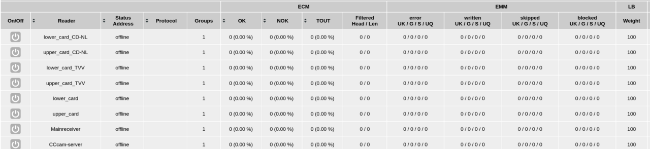

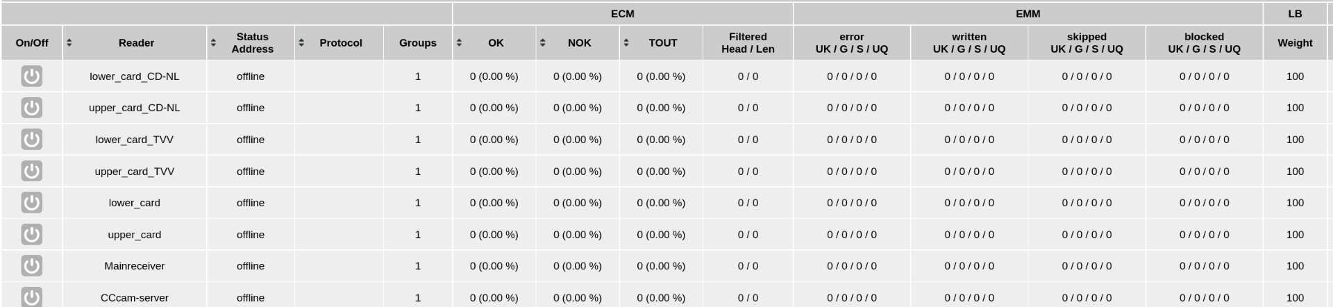

andlinux Geplaatst: 1 januari Geplaatst: 1 januari (aangepast) Hier is nog niet veel te zien. Nu was ik eens in de instellingen van oscam aan het kijken en vind het vreemd dat er geen reader geactiveerd is, is dat normaal niet automatisch waar de smartcard insteekt? Edit: Als ik de TVV kaart insteek krijg ik het volgende te zien in het de live log van oscam: 2026/01/01 09:22:04 6A402440 r (reader) lower_card [internal] card detected 2026/01/01 09:22:05 6A402440 r (reader) lower_card [internal] ATR: ** ** ** ** 01 40 96 70 ** 0A 0E ** ** ** 2026/01/01 09:22:06 6A402440 r (reader) lower_card [internal] detect seca/nagra tunneled card 2026/01/01 09:22:07 6A402440 r (reader) lower_card [internal] Nagra layer found 2026/01/01 09:22:07 6A402440 r (reader) lower_card [internal] Rom revision: DNASP400 RevI4G 2026/01/01 09:22:22 6A402440 r (reader) lower_card [internal] card system not supported 2026/01/01 09:22:22 6A402440 r (reader) lower_card [internal] Normal mode failed, reverting to Deprecated Mode 2026/01/01 09:22:23 6A402440 r (reader) lower_card [internal] ERROR: no characters found in ATR! 2026/01/01 09:22:23 6A402440 r (reader) lower_card [internal] Deactivating card 2026/01/01 09:22:23 6A402440 r (reader) lower_card [internal] Read ATR fail, attempt 1/7 fs = 9 2026/01/01 09:22:25 6A402440 r (reader) lower_card [internal] ERROR: no characters found in ATR! 2026/01/01 09:22:25 6A402440 r (reader) lower_card [internal] Deactivating card 2026/01/01 09:22:25 6A402440 r (reader) lower_card [internal] Read ATR fail, attempt 2/7 fs = 8 2026/01/01 09:22:25 6A402440 r (reader) lower_card [internal] ATR: ** ** ** ** 01 40 96 70 ** 0A 0E ** ** ** 2026/01/01 09:22:27 6A402440 r (reader) lower_card [internal] detect seca/nagra tunneled card 2026/01/01 09:22:28 6A402440 r (reader) lower_card [internal] Nagra layer found 2026/01/01 09:22:28 6A402440 r (reader) lower_card [internal] Rom revision: DNASP400 RevI4G 2026/01/01 09:22:43 6A402440 r (reader) lower_card [internal] card system not supported 2026/01/01 09:22:43 6A402440 r (reader) lower_card [internal] Try reset reader before each command 2026/01/01 09:22:43 6A402440 r (reader) lower_card [internal] ATR: ** ** ** ** 01 40 96 70 ** 0A 0E ** ** ** 2026/01/01 09:22:45 6A402440 r (reader) lower_card [internal] detect seca/nagra tunneled card 2026/01/01 09:23:00 6A402440 r (reader) lower_card [internal] Nagra layer found 2026/01/01 09:23:00 6A402440 r (reader) lower_card [internal] Rom revision: ,#$ր 2026/01/01 09:23:10 6A402440 r (reader) lower_card [internal] card system not supported 2026/01/01 09:23:10 6A402440 r (reader) lower_card [internal] THIS WAS A FAILED START ATTEMPT No 1 out of max allotted of 1 2026/01/01 09:23:10 6A402440 r (reader) lower_card [internal] card initializing error 1 januari aangepast door andlinux

Codx Geplaatst: 1 januari Geplaatst: 1 januari 2 uren geleden, andlinux zei: Hier is nog niet veel te zien. Nu was ik eens in de instellingen van oscam aan het kijken en vind het vreemd dat er geen reader geactiveerd is, is dat normaal niet automatisch waar de smartcard insteekt? Edit: Als ik de TVV kaart insteek krijg ik het volgende te zien in het de live log van oscam: 2026/01/01 09:22:04 6A402440 r (reader) lower_card [internal] card detected 2026/01/01 09:22:05 6A402440 r (reader) lower_card [internal] ATR: ** ** ** ** 01 40 96 70 ** 0A 0E ** ** ** 2026/01/01 09:22:06 6A402440 r (reader) lower_card [internal] detect seca/nagra tunneled card 2026/01/01 09:22:07 6A402440 r (reader) lower_card [internal] Nagra layer found 2026/01/01 09:22:07 6A402440 r (reader) lower_card [internal] Rom revision: DNASP400 RevI4G 2026/01/01 09:22:22 6A402440 r (reader) lower_card [internal] card system not supported 2026/01/01 09:22:22 6A402440 r (reader) lower_card [internal] Normal mode failed, reverting to Deprecated Mode 2026/01/01 09:22:23 6A402440 r (reader) lower_card [internal] ERROR: no characters found in ATR! 2026/01/01 09:22:23 6A402440 r (reader) lower_card [internal] Deactivating card 2026/01/01 09:22:23 6A402440 r (reader) lower_card [internal] Read ATR fail, attempt 1/7 fs = 9 2026/01/01 09:22:25 6A402440 r (reader) lower_card [internal] ERROR: no characters found in ATR! 2026/01/01 09:22:25 6A402440 r (reader) lower_card [internal] Deactivating card 2026/01/01 09:22:25 6A402440 r (reader) lower_card [internal] Read ATR fail, attempt 2/7 fs = 8 2026/01/01 09:22:25 6A402440 r (reader) lower_card [internal] ATR: ** ** ** ** 01 40 96 70 ** 0A 0E ** ** ** 2026/01/01 09:22:27 6A402440 r (reader) lower_card [internal] detect seca/nagra tunneled card 2026/01/01 09:22:28 6A402440 r (reader) lower_card [internal] Nagra layer found 2026/01/01 09:22:28 6A402440 r (reader) lower_card [internal] Rom revision: DNASP400 RevI4G 2026/01/01 09:22:43 6A402440 r (reader) lower_card [internal] card system not supported 2026/01/01 09:22:43 6A402440 r (reader) lower_card [internal] Try reset reader before each command 2026/01/01 09:22:43 6A402440 r (reader) lower_card [internal] ATR: ** ** ** ** 01 40 96 70 ** 0A 0E ** ** ** 2026/01/01 09:22:45 6A402440 r (reader) lower_card [internal] detect seca/nagra tunneled card 2026/01/01 09:23:00 6A402440 r (reader) lower_card [internal] Nagra layer found 2026/01/01 09:23:00 6A402440 r (reader) lower_card [internal] Rom revision: ,#$ր 2026/01/01 09:23:10 6A402440 r (reader) lower_card [internal] card system not supported 2026/01/01 09:23:10 6A402440 r (reader) lower_card [internal] THIS WAS A FAILED START ATTEMPT No 1 out of max allotted of 1 2026/01/01 09:23:10 6A402440 r (reader) lower_card [internal] card initializing error Jou kaart zit er niet goed in of je moet alles herstarten. SCHOTEL: 1,2 Mtr 50E-55W / 60cm Astra 19/23 / Airspy R2 SDR 24-1800 Mhz RECEIVERS: Dreambox 920 UHD/DM8000/800SE / VU+ Ultimo 4K Sat & Kabel & T2 / Rpi2 ADS-B FlightFeeder IPTV: KPN Glas (AoN) 1 Gbit & IPTV KPN plus+ TV box / Android 4K IPTV box / Kodi & Plex / 100+ TB Storage
