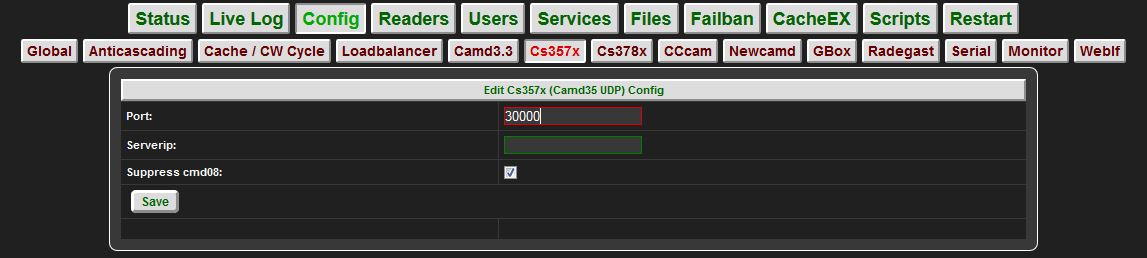

[cs357x]
port                          = 30000
suppresscmd08                 = 1
