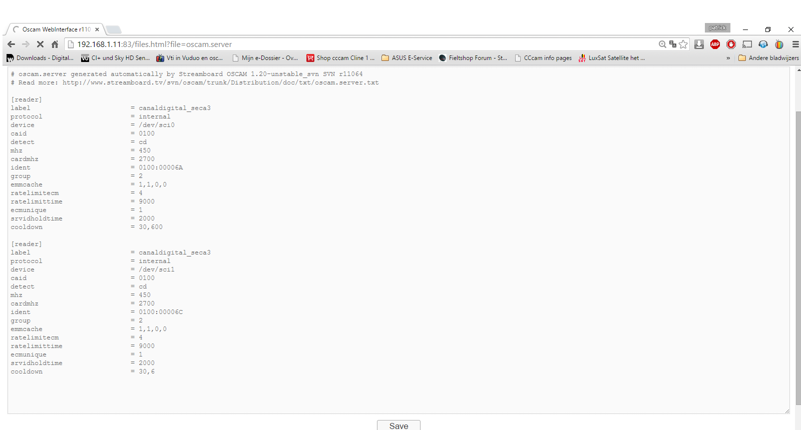

zo staat mn oscam
Verander je reader label even in TV Vlaanderen of in elk geval niet hetzelfde. Je definieert nu dezelfde label en dan werkt alleen de laatste...
[reader]
label                         = ReaderTVVkaartOnder
protocol                      = internal
device                        = /dev/sci1
detect                        = cd
mhz                           = 500
ident                         = 0100:00006C
group                         = 1
emmcache                      = 1,3,2

[reader]
label                         = canaldigital_seca3
protocol                      = internal
device                        = /dev/sci0
caid                          = 0100
detect                        = cd
mhz                           = 450
cardmhz                       = 2700
ident                         = 0100:00006A
group                         = 2
emmcache                      = 1,1,0,0
ratelimitecm                  = 4
ratelimittime                 = 9000
ecmunique                     = 1
srvidholdtime                 = 2000
cooldown                      = 30,600

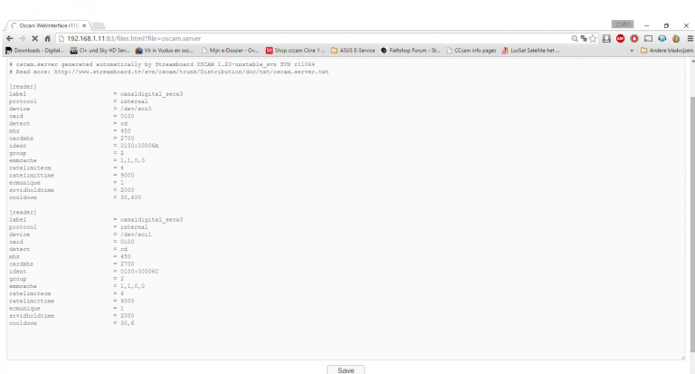

[reader]
protocol                      = internal
device                        = /dev/sci1
caid                          = 0100
detect                        = cd
mhz                           = 450
cardmhz                       = 2700
ident                         = 0100:00006C
group                         = 1
emmcache                      = 1,3,2,0
ratelimitecm                  = 4
ecmunique                     = 1
cooldown                      = 30,6
