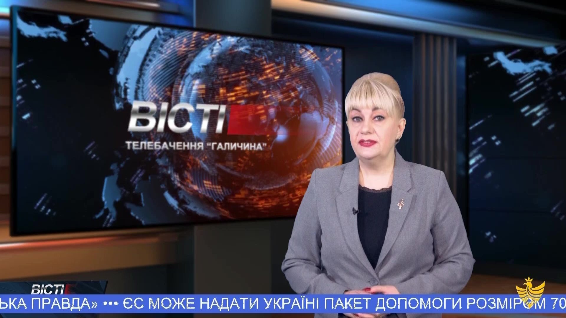

Astra 4A - 4,8°E : 12073 H 30000 2/3  ID: GALYCHYNA HD

"GALYCHYNA HD" nieuw via 12.073 h 30.000 fec 2/3 8PSK.
parallel aan de uitzending op 11.747 V 30.000 FEC 3/4 8PSK
Name: "GALYCHYNA HD" Provider: "SLM"
12073, H, 30000 8PSK FEC 2/3
4.8°E (0048 - Astra 4A SES-5)
4:2:0 1920x1080 25fps 2197kbps 16:9
NetwordID: 85 TransponderID: 4219 ServiceID: 7540
Video: 7541(H.264) Audio: 7542 -
PCR: 7541 PMT: 7540 Teletext: 0
