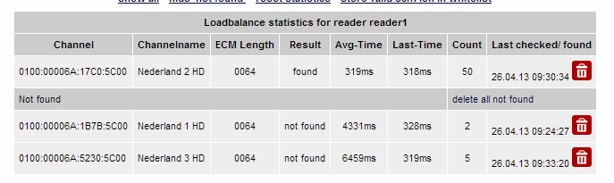

Ik heb er de laatste tijd ook last van, en inderdaad ook heel vaak op NED3 HD.. Maar ook op SBS6 en Eredivisie
(0100&00006A/5C00/17CA/64:CB5AEAF74619D60ECCFBD1537970321C): not found (557 ms) by reader (P/1/1/5) - SBS 6 HD (reader ins3c card res: 96 0
(0100&00006A/5C00/17CC/64:80681763571A5370C456738AEB4BABF8): not found (515 ms) by reader (P/1/1/5) - Eredivisie Live 1 HD (reader ins3c card res: 96 0
aangepast door -= [ Appien ] =-
Ik draai met een redelijke nieuwe build hoor : OSCAM 1.20-unstable_svn build r8621   :whistle:
Gisteravond geen last gehad, nu NED1 en 3 in de not found list.
Reader1 is een FTV kaart waar alleen NED123 vast op zit.
2013/04/26 08:09:34 B61B80F0 c db7020 (0100&00006A/5C00/1B7B/64:9BA75034FA101A5DEEE5365EE6E61AE2): not found (462 ms) by reader1 (P/1/1/5) - Nederland 1 HD (reader1 ins3c card res: 96 0
2013/04/26 08:09:50 B61B80F0 c db7020 (0100&00006A/5C00/1B7B/64:702624582A4C0A3AC050B9D7DDCBB856): not found (468 ms) by reader1 (P/1/1/5) - Nederland 1 HD (reader1 ins3c card res: 96 0
2013/04/26 08:10:34 B61B80F0 c db7020 (0100&00006A/5C00/1B7B/64:034F26B2BA5E5A8A61091F975CBB9227): not found (547 ms) by reader1 (P/1/1/5) - Nederland 1 HD (reader1 ins3c card res: 96 0
2013/04/26 08:14:25 B61B80F0 c db7020 (0100&00006A/5C00/1B7B/64:844AA2274BDE175FB56EC864377C08A4): rejected  (418 ms) by reader1 (P/2/2/5) - Nederland 1 HD
2013/04/26 08:29:49 B61B80F0 c db7020 (0100&00006A/5C00/1B7B/64:2FCDC4F2E0BC5138ACDEE5601EC5C1ED): not found (552 ms) by reader1 (P/2/2/5) - Nederland 1 HD (reader1 ins3c card res: 96 0
2013/04/26 08:31:03 B61B80F0 c db7020 (0100&00006A/5C00/1B7B/64:BF0B1CE8ABB1A20E28363A38CCEDB1F1): rejected  (419 ms) by reader1 (P/2/2/5) - Nederland 1 HD
2013/04/26 08:41:52 B61B80F0 c db7020 (0100&00006A/5C00/1B7B/64:57CA94374000257077418EF29A0CA374): not found (359 ms) by reader1 (P/2/2/5) - Nederland 1 HD (reader1 ins3c card res: 96 0
2013/04/26 09:03:52 B61B80F0 c db7020 (0100&00006A/5C00/1B7B/64:CDABA8D245C55EEC03CA797063027BEC): not found (380 ms) by reader1 (P/2/2/5) - Nederland 1 HD (reader1 unsubscribed)
2013/04/26 09:12:19 B61B80F0 c db7020 (0100&00006A/5C00/1B7B/64:20FA2FF5F6B80DB6CB76C0158048D2C1): not found (377 ms) by reader1 (P/2/2/5) - Nederland 1 HD (reader1 unsubscribed)
2013/04/26 09:13:24 B61B80F0 c db7020 (0100&00006A/5C00/1B7B/64:05DDE18CAB32ACE66A53A1BDA13F6F2C): not found (365 ms) by reader1 (P/2/2/5) - Nederland 1 HD (reader1 ins3c card res: 96 0
Bij jou speelt wat anders, immers de 5C00 is present. Gewoon een kreupele ecm als je het mij vraagt en dan gaat die channel op de blacklist omdat de kaart aangeeft die ecm niet te kunnen verwerken.
