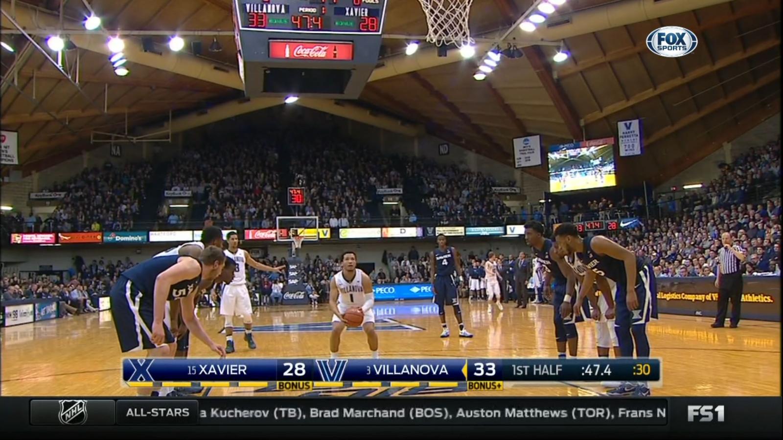

  Name: "FOX SPORT EUROPE"    Provider: "MX1"
  12556, V, 4035 8PSK FEC 5/6
   7.0°E (0070 - Eutelsat 7A)
  Signal: 77%    Quality: 98%
  4:2:0 1920x1080 -fps 7291kbps  16:9
  NetwordID: 1   TransponderID: 15   ServiceID: 1
  Video: 256(H.264) Audio: 4113  -    (MPEG-1)
  PCR: 513  PMT: 2048 Teletext: 0
ECM/EMM LIST
  1) CA-Type:  9728  (0x2600) BISS/EBU      ECM:  8191  (0x1FFF) <-- SELECTED
  EMMs: 8191 (SELECTED)
  11/01/2017 10:42:44   (GMT +1)
