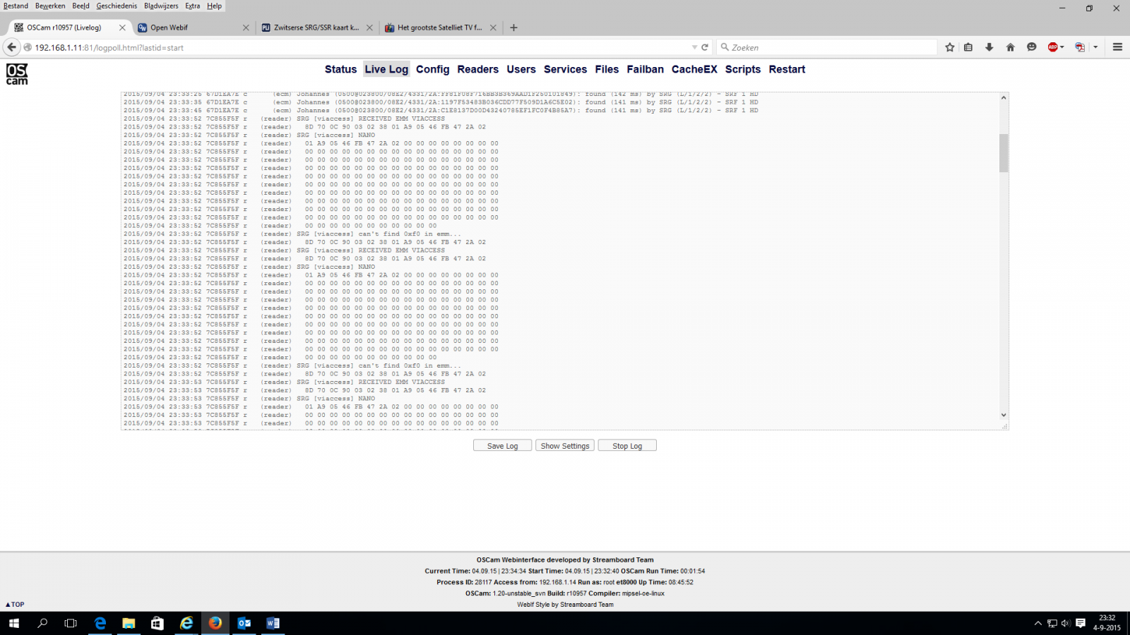

  • 2015/08/05 20:25:34 58B088 r (reader) SRG [viaccess] NANO
  • 2015/08/05 20:25:34 58B088 r (reader) F0 08 06 96 4D 21 F0 A6 81 78
  • 2015/08/05 20:25:34 58B088 r (reader) SRG [viaccess] Johannes emmtype=shared, len=60, cnt=1: written (523 ms)
  • 2015/08/05 20:25:35 EAA9F0 c (ecm) Johannes (0500&023800/08E2/36E3/2A:AD9E440E3C8A30DE59DBED6FA49AFC76): found (218 ms) by SRG (L/1/3/3) - RSI LA 1 HD
  • 2015/08/05 20:25:45 EAA9F0 c (ecm) Johannes (0500&023800/08E2/36E3/2A:DDBB164052ADFA1B1F0190C4D501F622): found (140 ms) by SRG (L/1/3/3) - RSI LA 1 HD
  • 2015/08/05 20:25:55 EAA9F0 c (ecm) Johannes (0500&023800/08E2/36E3/2A:0E818294EAC2C7CB55AFC4CB9D2244CA): found (141 ms) by SRG (L/1/3/3) - RSI LA 1 HD
  • 2015/08/05 20:26:02 58B088 r (reader) SRG [viaccess] RECEIVED EMM VIACCESS
  • 2015/08/05 20:26:02 58B088 r (reader) 8E 70 3C C2 97 63 00 90 03 02 38 01 9E 20 46 3C
  • 2015/08/05 20:26:02 58B088 r (reader) DF 76 16 D8 F7 C9 FF E4 79 D5 CE FD A5 9F B8 87
  • 2015/08/05 20:26:02 58B088 r (reader) 40 39 91 04 46 BF FF F3 23 61 EF 0B E0 57 A9 05
  • 2015/08/05 20:26:02 58B088 r (reader) 47 04 47 31 02 F0 08 52 97 83 5E EE E5 20 07
  • 2015/08/05 20:26:02 58B088 r (reader) SRG [viaccess] NANO
  • 2015/08/05 20:26:02 58B088 r (reader) 90 03 02 38 01
  • 2015/08/05 20:26:02 58B088 r (reader) 9E 20 46 3C DF 76 16 D8 F7 C9 FF E4 79 D5 CE FD
  • 2015/08/05 20:26:02 58B088 r (reader) A5 9F B8 87 40 39 91 04 46 BF FF F3 23 61 EF 0B
  • 2015/08/05 20:26:02 58B088 r (reader) E0 57
  • 2015/08/05 20:26:02 58B088 r (reader) A9 05 47 04 47 31 02
  • 2015/08/05 20:26:02 58B088 r (-) -- Skipped 2 duplicated log lines --
  • 2015/08/05 20:26:02 58B088 r (reader) SRG [viaccess] nano A9: class: 01, expiry date: 2015/08/04 - 2015/09/17
  • 2015/08/05 20:26:02 58B088 r (reader) SRG [viaccess] provid 023800 has matching class 01
  • 2015/08/05 20:26:02 58B088 r (reader) F0 08 52 97 83 5E EE E5 20 07
  • 2015/08/05 20:26:02 58B088 r (reader) SRG [viaccess] set subscription cmd:
  • 2015/08/05 20:26:02 58B088 r (reader) CA 18 01 01 11
  • 2015/08/05 20:26:02 58B088 r (reader) SRG [viaccess] set subscription data:
  • 2015/08/05 20:26:02 58B088 r (reader) A9 05 47 04 47 31 02 F0 08 52 97 83 5E EE E5 20
  • 2015/08/05 20:26:02 58B088 r (reader) 07
  • 2015/08/05 20:26:02 58B088 r (reader) SRG [viaccess] update error: 90 40
  • 2015/08/05 20:26:05 EAA9F0 c (ecm) Johannes (0500&023800/08E2/36E3/2A:F9132B0348586FAF279358E89037B866): found (219 ms) by SRG (L/1/3/3) - RSI LA 1 HD
  • 2015/08/05 20:26:15 EAA9F0 c (ecm) Johannes (0500&023800/08E2/36E3/2A:19C0040CDBB1C0D9E8D8C003D979FF98): found (140 ms) by SRG (L/1/3/3) - RSI LA 1 HD
  • 2015/08/05 20:26:25 EAA9F0 c (ecm) Johannes (0500&023800/08E2/36E3/2A:BF81EA29D078925A30528C330521B49A): found (138 ms) by SRG (L/1/3/3) - RSI LA 1 HD
  • 2015/08/05 20:26:35 EAA9F0 c (ecm) Johannes (0500&023800/08E2/36E3/2A:7203C191F0576479FFFCBFEF26F88C8F): found (141 ms) by SRG (L/1/3/3) - RSI LA 1 HD
  • 2015/08/05 20:26:45 EAA9F0 c (ecm) Johannes (0500&023800/08E2/36E3/2A:A391CA7D7E162C650CE388D15870158F): found (141 ms) by SRG (L/1/3/3) - RSI LA 1 HD
  • 2015/08/05 20:26:55 EAA9F0 c (ecm) Johannes (0500&023800/08E2/36E3/2A:29DB0946EE4B613D30A777994E9C6624): found (142 ms) by SRG (L/1/3/3) - RSI LA 1 HD
  • 2015/08/05 20:27:05 EAA9F0 c (ecm) Johannes (0500&023800/08E2/36E3/2A:0AD7313B84FB85DCBAD5F7182F1531FE): found (140 ms) by SRG (L/1/3/3) - RSI LA 1 HD
  • 2015/08/05 20:27:15 EAA9F0 c (ecm) Johannes (0500&023800/08E2/36E3/2A:8DFAA46DB28575C54327B381FF5038FD): found (140 ms) by SRG (L/1/3/3) - RSI LA 1 HD
  • 2015/08/05 20:27:20 10D7708 c (work) user Boxboven reached 120 sec idle limit.
  • 2015/08/05 20:27:25 EAA9F0 c (ecm) Johannes (0500&023800/08E2/36E3/2A:BFAF7F31282A9CFE23FEA478ACE0E1B8): found (141 ms) by SRG (L/1/3/3) - RSI LA 1 HD
  • 2015/08/05 20:27:35 EAA9F0 c (ecm) Johannes (0500&023800/08E2/36E3/2A:271939B5C00134C10F9A046F3025D322): found (141 ms) by SRG (L/1/3/3) - RSI LA 1 HD
  • 2015/08/05 20:27:39 58B088 r (reader) SRG [viaccess] RECEIVED EMM VIACCESS
  • 2015/08/05 20:27:39 58B088 r (reader) 8E 70 3C C2 97 63 00 90 03 02 38 01 9E 20 46 3C
  • 2015/08/05 20:27:39 58B088 r (reader) DF 76 16 D8 F7 C9 FF E4 79 D5 CE FD A5 9F B8 87
  • 2015/08/05 20:27:39 58B088 r (reader) 40 39 91 04 46 BF FF F3 23 61 EF 0B E0 57 A9 05
  • 2015/08/05 20:27:39 58B088 r (reader) 46 FB 47 2A 02 F0 08 06 96 4D 21 F0 A6 81 78
  • 2015/08/05 20:27:39 58B088 r (reader) SRG [viaccess] NANO
  • 2015/08/05 20:27:39 58B088 r (reader) 90 03 02 38 01
  • 2015/08/05 20:27:39 58B088 r (reader) 9E 20 46 3C DF 76 16 D8 F7 C9 FF E4 79 D5 CE FD
  • 2015/08/05 20:27:39 58B088 r (reader) A5 9F B8 87 40 39 91 04 46 BF FF F3 23 61 EF 0B
  • 2015/08/05 20:27:39 58B088 r (reader) E0 57
  • 2015/08/05 20:27:39 58B088 r (-) -- Skipped 1 duplicated log lines --
  • 2015/08/05 20:27:39 58B088 r (reader) A9 05 46 FB 47 2A 02
  • 2015/08/05 20:27:39 58B088 r (reader) SRG [viaccess] nano A9: class: 01, expiry date: 2015/07/27 - 2015/09/10
  • 2015/08/05 20:27:39 58B088 r (reader) SRG [viaccess] provid 023800 has matching class 01
  • 2015/08/05 20:27:39 58B088 r (reader) F0 08 06 96 4D 21 F0 A6 81 78
  • 2015/08/05 20:27:40 58B088 r (reader) SRG [viaccess] Johannes emmtype=shared, len=60, cnt=2: written (415 ms)
  • 2015/08/05 20:27:45 EAA9F0 c (ecm) Johannes (0500&023800/08E2/36E3/2A:6831EC45872402657BD3C638E5E6A732): found (220 ms) by SRG (L/1/3/3) - RSI LA 1 HD
  • 2015/08/05 20:27:55 EAA9F0 c (ecm) Johannes (0500&023800/08E2/36E3/2A:F86A0006D44D1E5411F0EBED1AA20F0A): found (140 ms) by SRG (L/1/3/3) - RSI LA 1 HD
  • 2015/08/05 20:28:05 EAA9F0 c (ecm) Johannes (0500&023800/08E2/36E3/2A:3EA7782AB93DEADF199AD5C006DD9129): found (140 ms) by SRG (L/1/3/3) - RSI LA 1 HD
  • 2015/08/05 20:28:08 58B088 r (reader) SRG [viaccess] RECEIVED EMM VIACCESS
  • 2015/08/05 20:28:08 58B088 r (reader) 8E 70 3C C2 97 63 00 90 03 02 38 01 9E 20 46 3C
  • 2015/08/05 20:28:08 58B088 r (reader) DF 76 16 D8 F7 C9 FF E4 79 D5 CE FD A5 9F B8 87
  • 2015/08/05 20:28:08 58B088 r (reader) 40 39 91 04 46 BF FF F3 23 61 EF 0B E0 57 A9 05
  • 2015/08/05 20:28:08 58B088 r (reader) 47 04 47 31 02 F0 08 52 97 83 5E EE E5 20 07
  • 2015/08/05 20:28:08 58B088 r (reader) SRG [viaccess] NANO
  • 2015/08/05 20:28:08 58B088 r (reader) 90 03 02 38 01
  • 2015/08/05 20:28:08 58B088 r (reader) 9E 20 46 3C DF 76 16 D8 F7 C9 FF E4 79 D5 CE FD
  • 2015/08/05 20:28:08 58B088 r (reader) A5 9F B8 87 40 39 91 04 46 BF FF F3 23 61 EF 0B
  • 2015/08/05 20:28:08 58B088 r (reader) E0 57
  • 2015/08/05 20:28:08 58B088 r (reader) A9 05 47 04 47 31 02
  • 2015/08/05 20:28:08 58B088 r (-) -- Skipped 2 duplicated log lines --
  • 2015/08/05 20:28:08 58B088 r (reader) SRG [viaccess] nano A9: class: 01, expiry date: 2015/08/04 - 2015/09/17
  • 2015/08/05 20:28:08 58B088 r (reader) SRG [viaccess] provid 023800 has matching class 01
  • 2015/08/05 20:28:08 58B088 r (reader) F0 08 52 97 83 5E EE E5 20 07
  • 2015/08/05 20:28:08 58B088 r (reader) SRG [viaccess] set subscription cmd:
  • 2015/08/05 20:28:08 58B088 r (reader) CA 18 01 01 11
  • 2015/08/05 20:28:08 58B088 r (reader) SRG [viaccess] set subscription data:
  • 2015/08/05 20:28:08 58B088 r (reader) A9 05 47 04 47 31 02 F0 08 52 97 83 5E EE E5 20
  • 2015/08/05 20:28:08 58B088 r (reader) 07
  • 2015/08/05 20:28:08 58B088 r (reader) SRG [viaccess] update error: 90 40
  • 2015/08/05 20:28:16 EAA9F0 c (ecm) Johannes (0500&023800/08E2/36E3/2A:C9FFDF28B58C0E30CD468C1608B13810): found (219 ms) by SRG (L/1/3/3) - RSI LA 1 HD
  • 2015/08/05 20:28:25 EAA9F0 c (ecm) Johannes (0500&023800/08E2/36E3/2A:C82904BD47B3EEEA786517D5D5A57CF3): found (141 ms) by SRG (L/1/3/3) - RSI LA 1 HD
  • 2015/08/05 20:28:35 EAA9F0 c (ecm) Johannes (0500&023800/08E2/36E3/2A:4469A754D88B2BCE586C6EBBC96171C5): found (140 ms) by SRG (L/1/3/3) - RSI LA 1 HD

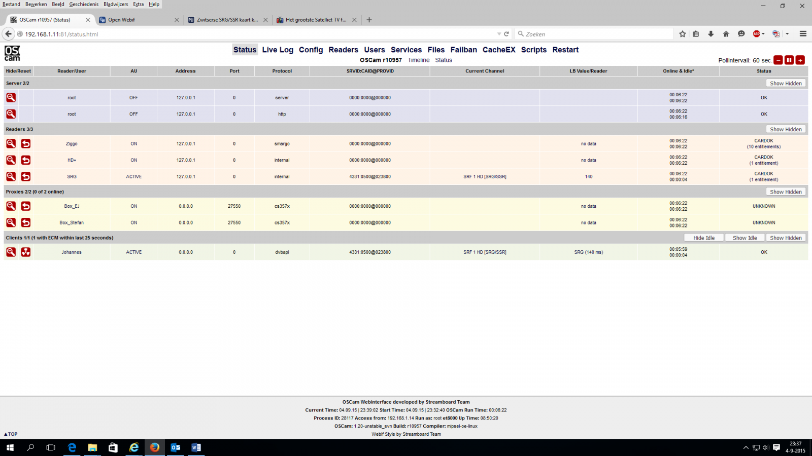

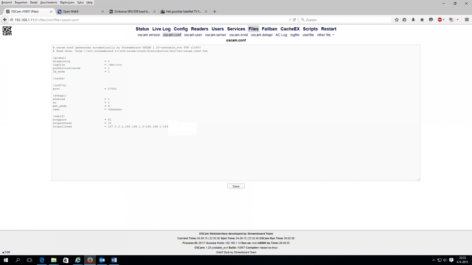

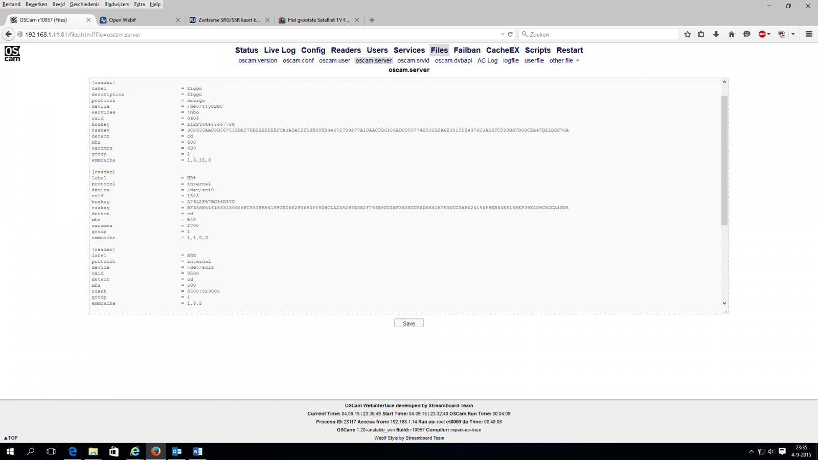

Hier de reader in de et8000
[reader]
label                         = SRG
protocol                      = internal
device                        = /dev/sci0
caid                          = 0500
detect                        = cd
mhz                           = 500
ident                         = 0500:023800
group                         = 1
emmcache                      = 1,3,2
Heb een versie 3 kaart.
Mijn ziggo kaart wordt wel keruig geupdate.
Wie kan mij vertellen wat er fout gaat om dit probleem op te lossen ?

90 40 wil zeggen EMM ERROR. Volgens Streamboard is er ooit een fix geweest voor optie 3c. Is alweer 2 jaar geleden. Weet niet of je zelf je OScam compileert of dat je hem uit een feed haalt. Lijkt er dus op dat SRG 'iets' heeft gewijzigd in de EMM structuur..

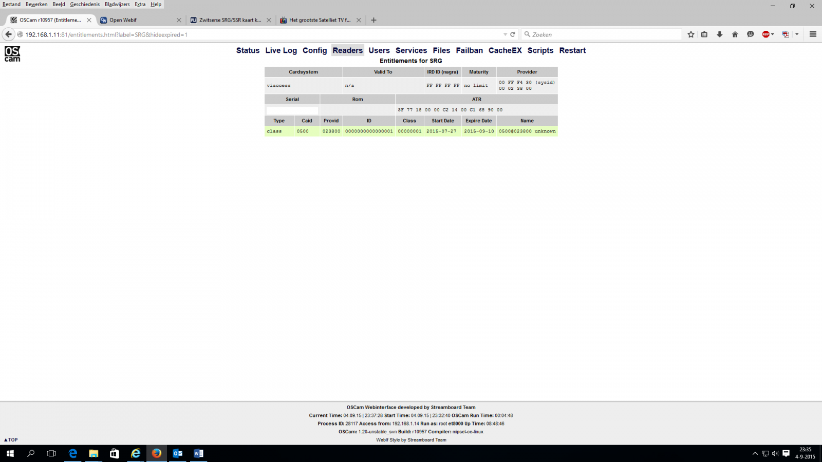

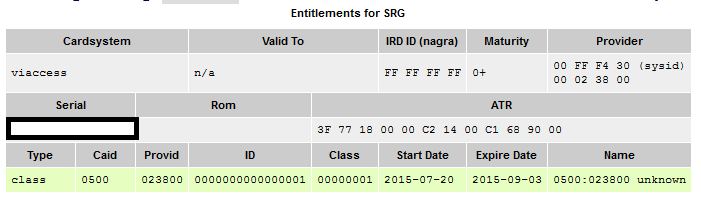

Wat een kouwe drukte: de entitlement is nog niet eens verlopen (!)
De kaart antwoord altijd 9040 als de emm al eens verwerkt is of als de class niet aanwezig is op de kaart.
Ik beging er weer over , omdat altijd als die entitlement verlopen is er altijd een hoop gedoe is om hem weer geupdate te krijgen. Ik wil graag van die gedoe af. Mijn andere kaarten hebben deze problemen niet.

Hij is nu verlopen. Ik krijg de kaart met geen mogelijkheid in oscam geupdate. Wie weet wat ik fout doe

Deze OSCam: 1.20-unstable_svn Build: r10991 versie heb ik ook geprobeerd hielp helaas ook niks. Wie kan me helpen met die probleem? Wil graag weer Zwitserse tv kunnen kijken.
In het bezet van een VuPlus: Ultimo 4k HDD 10TB en VuPlus Ultimo 4k 4TB HDD.
                                                    3 Schotels Met: 5w,0.8w,3e,4,8e,7e,9e,13e,16e,19,2e,23,5e,28,2e en 39e,42e
                                               Smartkaarten :Ziggo, HD+, SRG/SSR,TIVUSAT Zilver 4k Ultra HD,TV Vlaanderen en TVR
Ik ben terug gegaan naar versie OSCAM: 1.20-unstable_svn Build: r9837 en daar werkt het updaten wel. Wat zit er fout in de nieuwere versie dat het updaten niet wil?
Moet het volgende niet bij je reader staan?
auprovid                      = 023800
emmcache                      = 1,1,15,0
Volgens mij is onderstaande ook nog nodig in oscam.conf (of staat er al?):
[dvbapi]
enabled                       = 1
au                            = 1
pmt_mode                      = 6
request_mode                  = 1
delayer                       = 60
user                          = Johannes
read_sdt                      = 2
write_sdt_prov                = 1
boxtype                       = dreambox
VU+ Duo
/ Dreambox DM800 / TBS 5925
