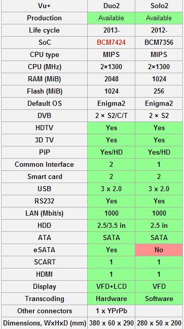

Ik twijfel ook! zie ook de reviews @ linux-tv.com
DUO2 meer toekomst bestendig?  :D
* Je kunt andere Tuners of meer Tuners plaatsen.
* Heeft Hardware matige Transcoding (On-the-fly transcoding of content into a variety of formats)
* (Extra) LCD display (niet echt een must)
* Betere SoC (http://www.broadcom.com/products/Satellite/Satellite-Set-Top-Box-Solutions)
* Meer RAM en Flash
* Interne voeding
* 2,5" en 3,5" HDD's
* Nadeel; groter en duurder +/- Euro 150,-  :(
Compared to the Solo2 we do see many improvements or added options if you would like.
Of course we now have the pluggable tuners and also a healthy increase on memory specs and the WiFi is built in.
The added 3.2” TFT LCD 262,000 colour front panel display also sets the Duo2 apart.
It is also worth a note that the Duo2 has dedicated hardware in the box for transcoding where as the Solo2 is software based.
On the Duo2 you can change the transcoding bit/frame rate while it was fixed on the Solo2.
On the connection side of things the Duo2 offers component video out and e-Sata.
On the Vu+ Duo2 you can also put in both a 2.5″ and 3.5″ hard drive while only 2.5 was supported on the Solo2.
The new Duo2 remote control is another difference between the two but as of yet we have still to try this as there is a delay on these.
aangepast door Psychostase
